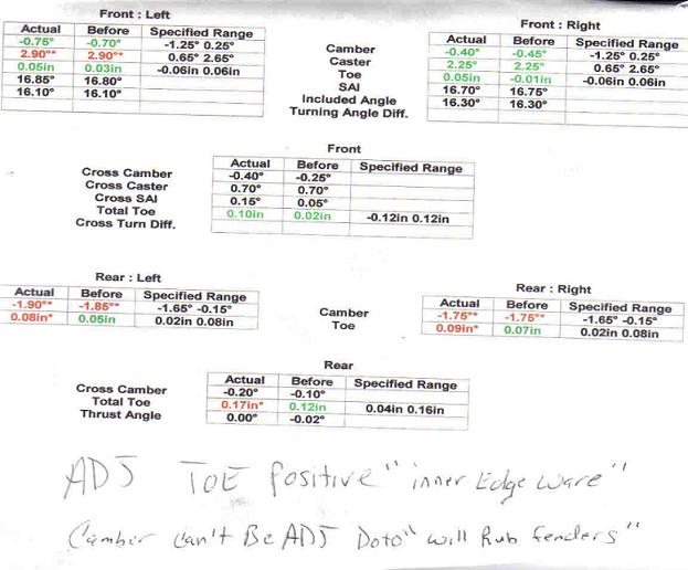

new BEAST alignment SHEET

is it just me or did his first alignment sheet looked better than this last one

what is wrong with the new alignment? isn't the front in spec? He said he changed the front toe so it will wear less for a lowered car. And he said he gave the back more toe for some reason.. and the camber in the back can't be adjusted because of the fender. I don't think if i take it to anywhere else it will be any better.. because me and the manager stood there while the technician did it. Although i won't go back there again.... O and the top of the sheet it got cut off, but it said honda civic SI, and mine is a EX ..

How low is this car?? I honestly think this shoip don't know what in the hell they are doing. If I were you, I'd pony up, pay elsewhere to have it done RIGHT, then take a new printout bakc to NTB and demand my money back. I don't have specs right now, but it is very possible that an SI has completely different specs then a coupe....

I am not as low as you are but I have -2 front and -.8 rear, but i asked for that.
The cast on the left front is off and the toe in rear has been set more positive. not terribly too positive, but positive toe will wear tires. Camber looks within spec though. Again, I don't think the guy knows what he is doing.

arg! he said he was an EXPERT on lowered cars... and that the guy who did it first time didn't know what he was doing!!!!!!!!!!!!!! Isn't toe how straight the tires are pointed? i should have just never gotten alignment, this is so gay

i say just get your money back because they left your rear toe out of spec. talk to the manager or something becuase this shop has no clue on how to do alignments.
