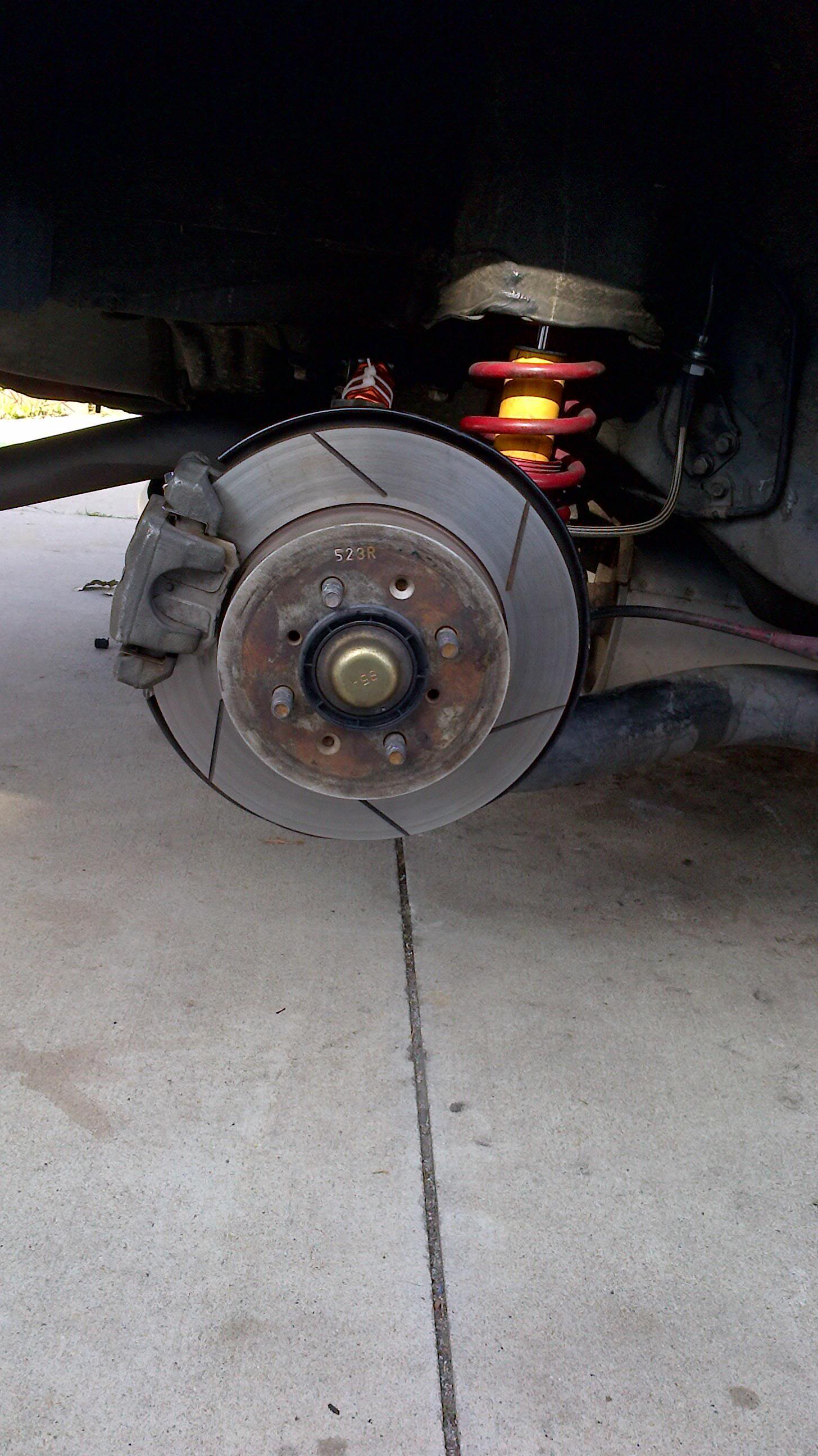

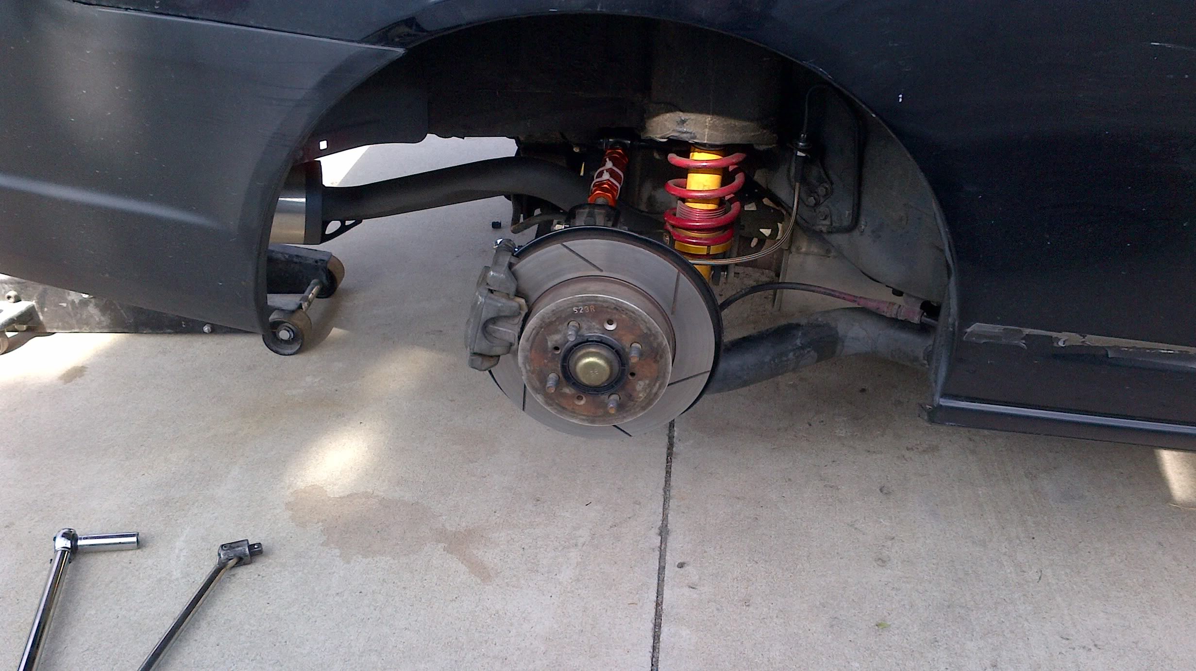

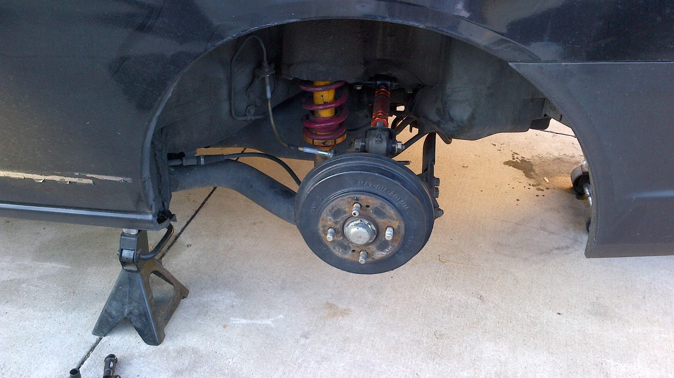

see? US = lame drums

its not that simple.
you need the whole knuckle assembly, rotos, calipers, pads, rear brake lines, rear e-brake lines...etc (from either a 02-03 civic si or the canadian acura EL)
here is the conversion on the same car (my car)
