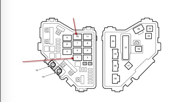

Did you replace the correct relay for the clutch? You sure? I am pretty sure but going to post the diagram of what I replaced...

I replaced number 1

Old Apr 22, 2015
Re: 2008 crv Ac issues...
Originally Posted by usajags84
I replaced number 1
That's the right one.
Do the radiator fans come on when you turn on the AC?
Yes
OK so the system is attempting to operate.
Pull that clutch relay out, turn AC on and test for 2 powers and 2 grounds in the socket.
Then ohm test the clutch coil from the relay socket
Micro relay diagram, socket terminals 3 and 5
One should have power from a fuse, the other goes to the clutch coil.
