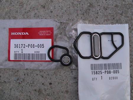

Hi guys,
I have to buy VTEC Solenoid gasket and the O-Ring
I cannot get them at local stores, so I have to buy them online.
I'm not sure how to look it up. I tried Amazon, but i get different items, that I dunno which one is correct.
My car is Honda Civic Ex 2001 1.7L Coupe
Where can I find these gaskets, or which part numbers should I look for?
I appreciate the help

It's part 10 and 21 here:
http://estore.honda.com/honda/parts/...1001&dl=208566
Old Apr 24, 2015
Re: Part number for VTEC Solenoid gaskets
HOLD IT! Back that truck up!!!
No, one of those numbers (21) is for the O ring that goes on the pressure switch.
For a 7th gen Civic:
The "filter" gasket number is 15825-P2M-005
The smaller gasket that fits under the solenoid is part number 36172-P08-015

Thank you for the replies guys.
Can the smaller gasket also cause oil leak?
Old Apr 26, 2015
Yes.
