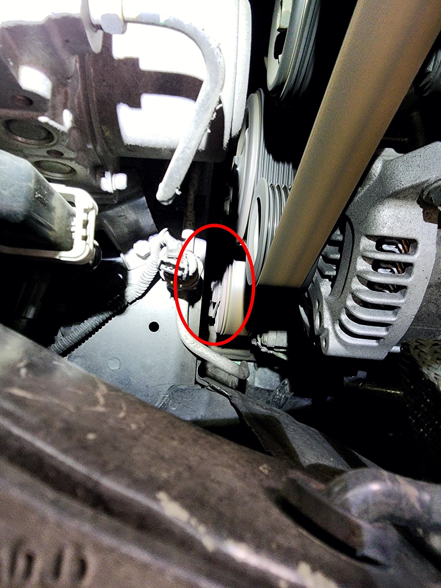

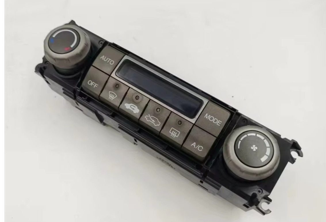

I bought the Heater Climate Control from AliExpress and installed it in my car, other functions work normally, but the air conditioner doesn't work. It changes to "A/C ON" on the lcd of it,
but The air conditioner compressor in the red circle does not turn even when the air conditioner is turned on, and the relay was replaced with a new product, but the problem is also the same.
How can I repair it? Please help me. Summer is coming. Summer in Korea is too hot.

I am Korean and Civic in Korea uses heater panel that looks like this.
I ordered this product for the second time and they all have the same problem.

System might be low or out of freon. Or the compressor might be bad.

답변해 주셔서 감사합니다, 친구.
그러나 고장난 lcd로 히터 패널을 연결하면 에어컨이 정상적으로 작동합니다.
