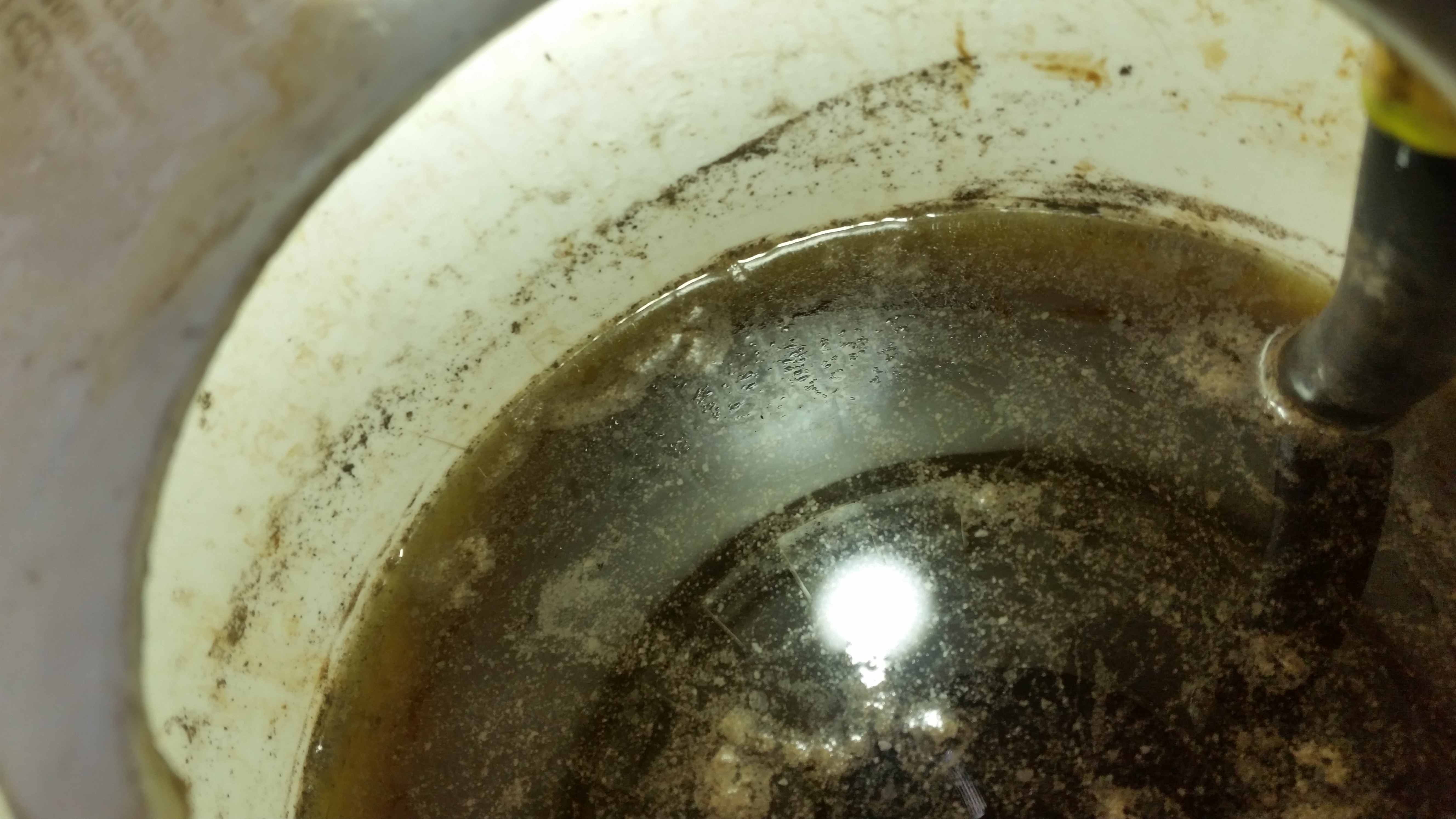

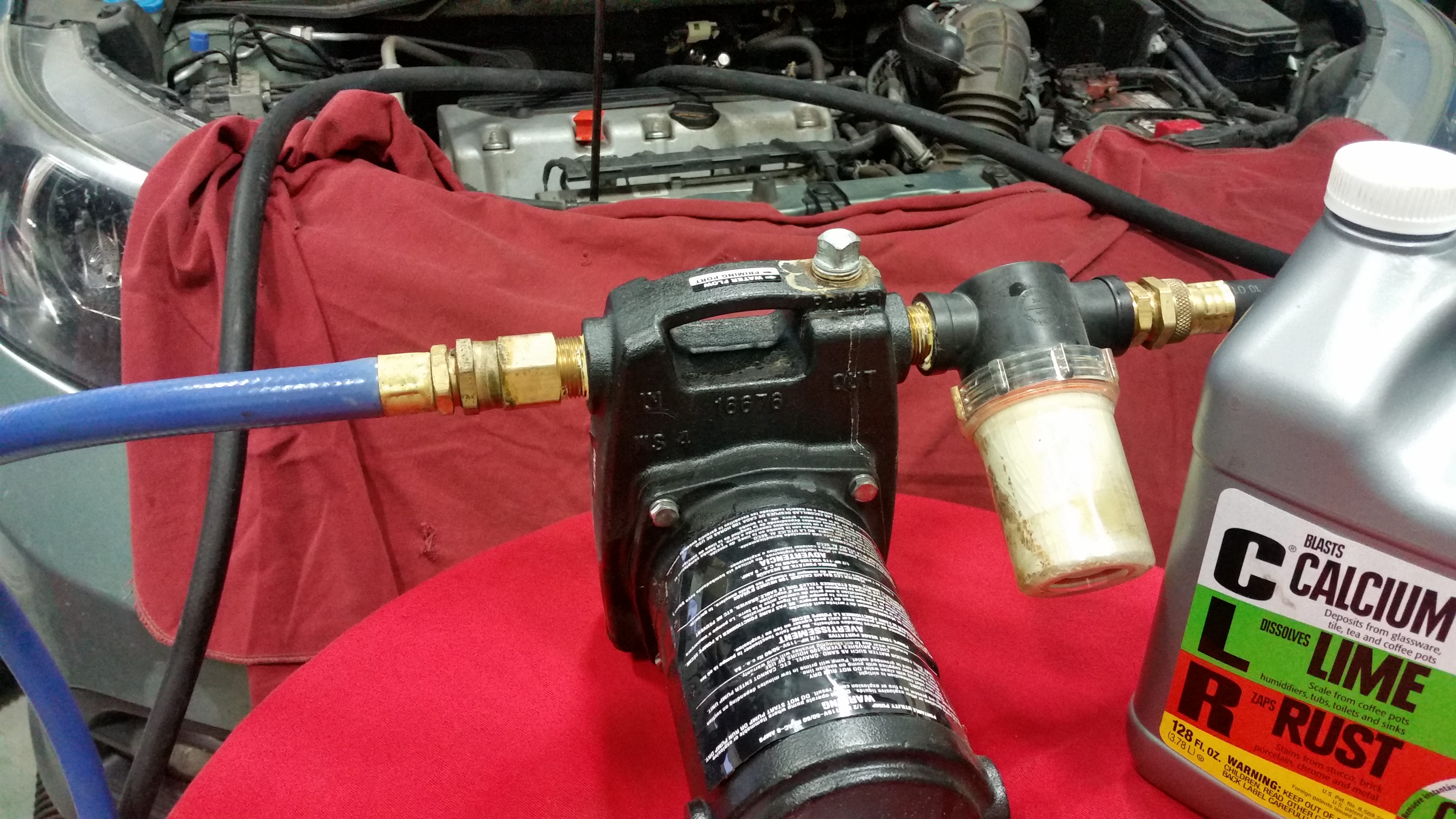

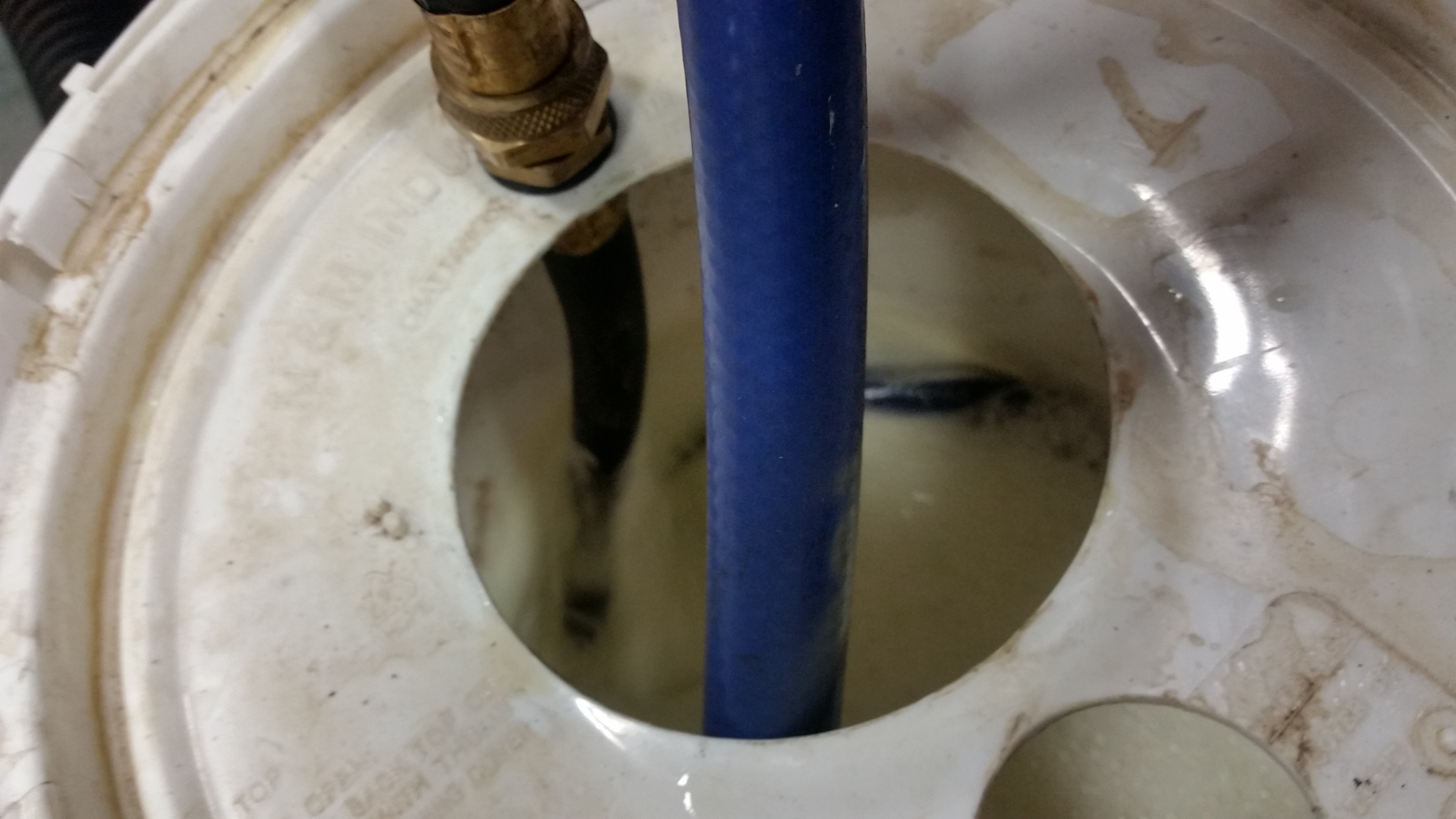

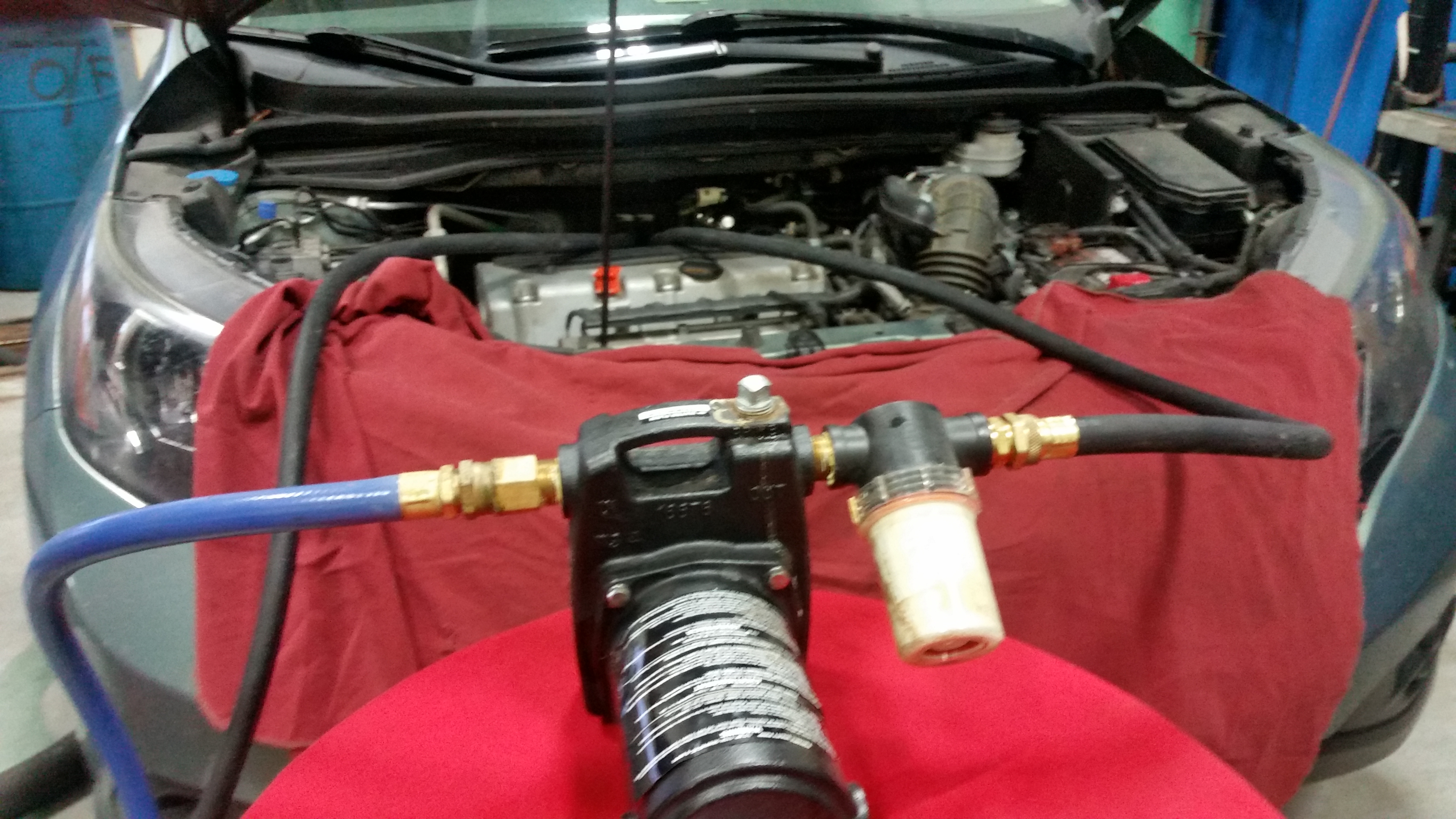

Had to do the described flush to a 12 CRV today and got a couple pics, first two are the pump (its hoses are already connected to the heater core pipes at the firewall, backflushing or backwards flow through the core), the bucket with one gallon of water and half gallon of CLR that is being circulated through the heater core, and the last pic is the same bucket after the flush period is over (I let this one run for at least 2 hours) with maybe a couple more gallons of water in it:

Yeah, that garbage stuck to the sides of the bucket and in the water came out of this CRV heater core. I'm pretty sure this bucket wasn't THAT dirty when I started.

(EDIT: this car actually came from another shop that wasn't able to solve the problem, and they apparently topped up the radiator with some green coolant after their attempt at flushing or whatever they did.....but this is not a new or unique issue, and it's happened to some of them quite early in their life)
The bulletin only describes the condition as being caused by a partially clogged heater core, it does not say specifically what the clog is caused by.
I just scooped a hand into that bucket now that it has settled overnight: the stuff is not grainy, it's more like slime. (But remember whatever is in the bucket has likely been dissolved by the CLR so I can't tell what it started out as.)
