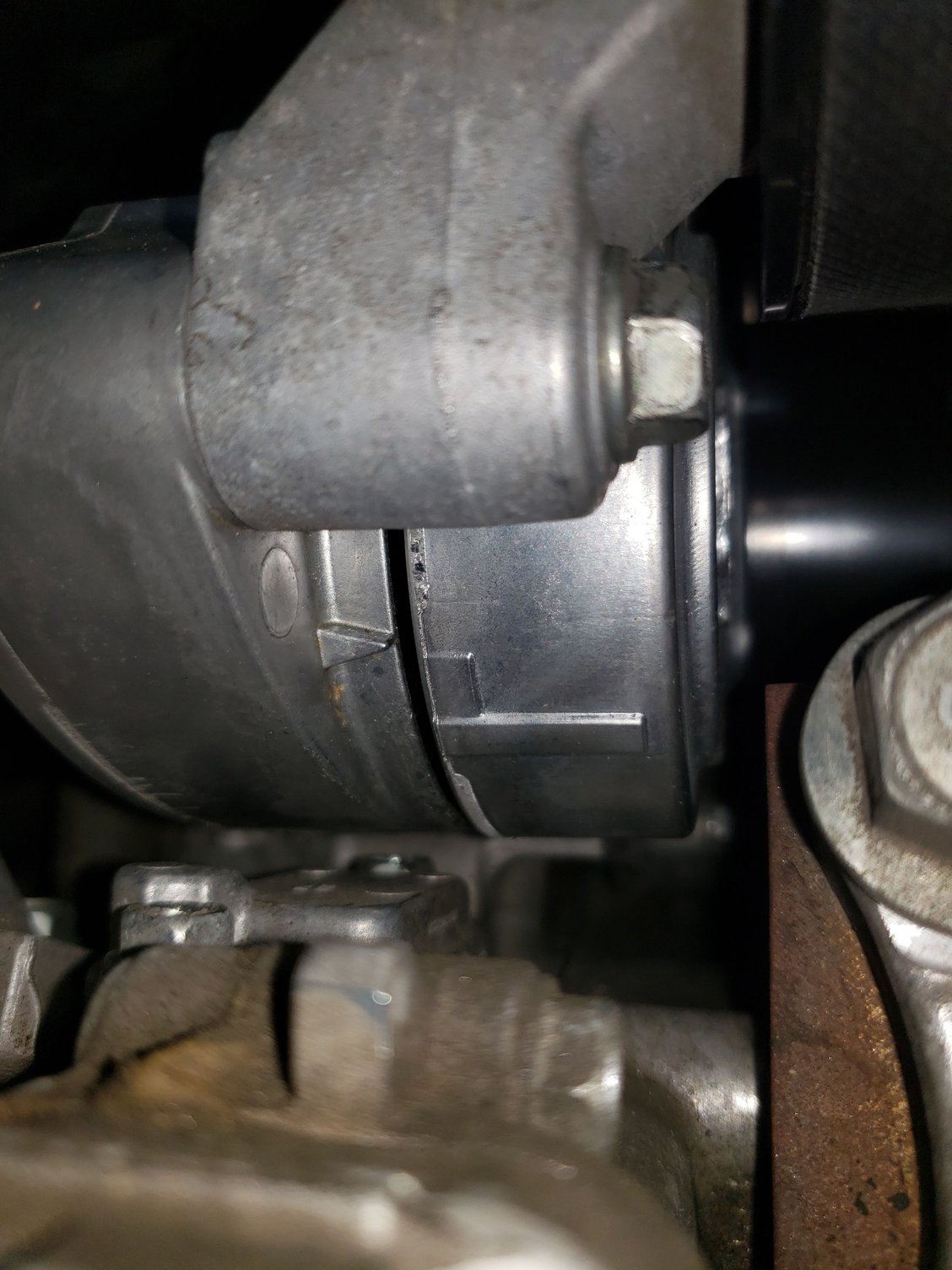

I replaced the belt tensioner, idler pully and the belt today. Will see if that solves the squealing issue. I did notice that the arrow on the new tensioner was still right at the edge of the marking. Not sure if this matters as long as the squealing stops.

Is that mark for when you have the tensioner cranked all the way over to get the belt on and off? Or for when the tensioner isn't under load?

That is a picture with everything installed (belt tensioner, idler pully and the new belt) under load. Its an auto tensioner so there is no adjusting it manually, the pic show where the arrow landed once everything was installed. I did just have the AC Compressor replaced by the dealership a little over a week ago as well. I assume the arrow should be in that square section when under load, if I was to take tension like i was going to remove the belt the arrow moves into that area.
