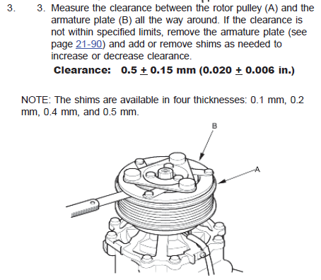

Check the compressor clutch gap clearance. If it's too wide the clutch can slip, causing heat, eventually tripping the thermal protection.
