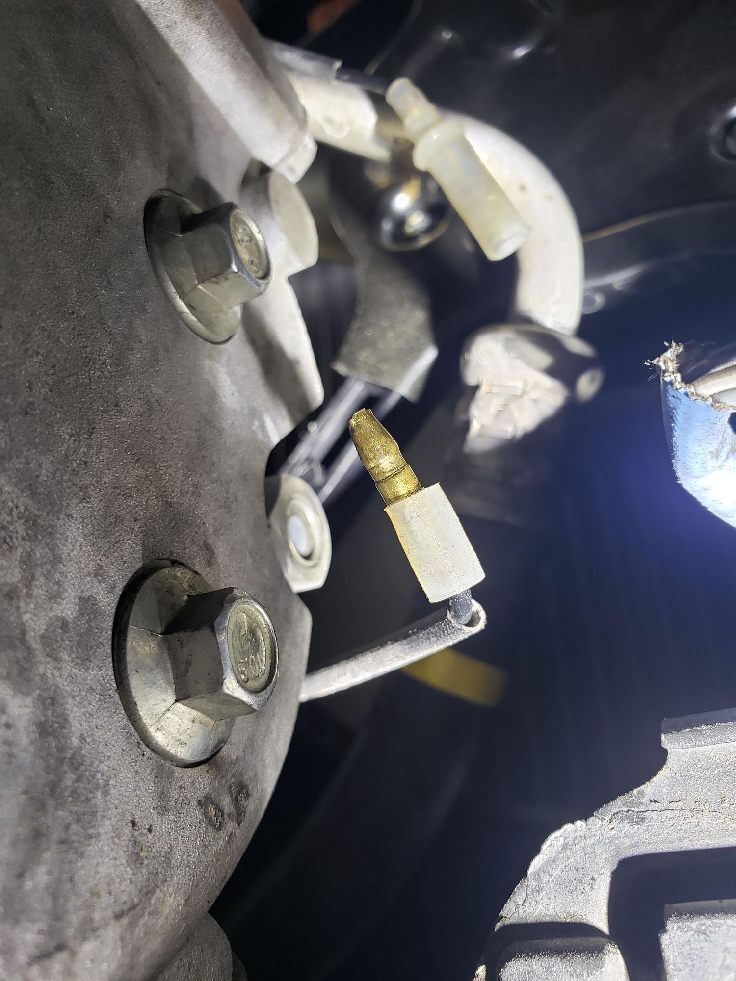

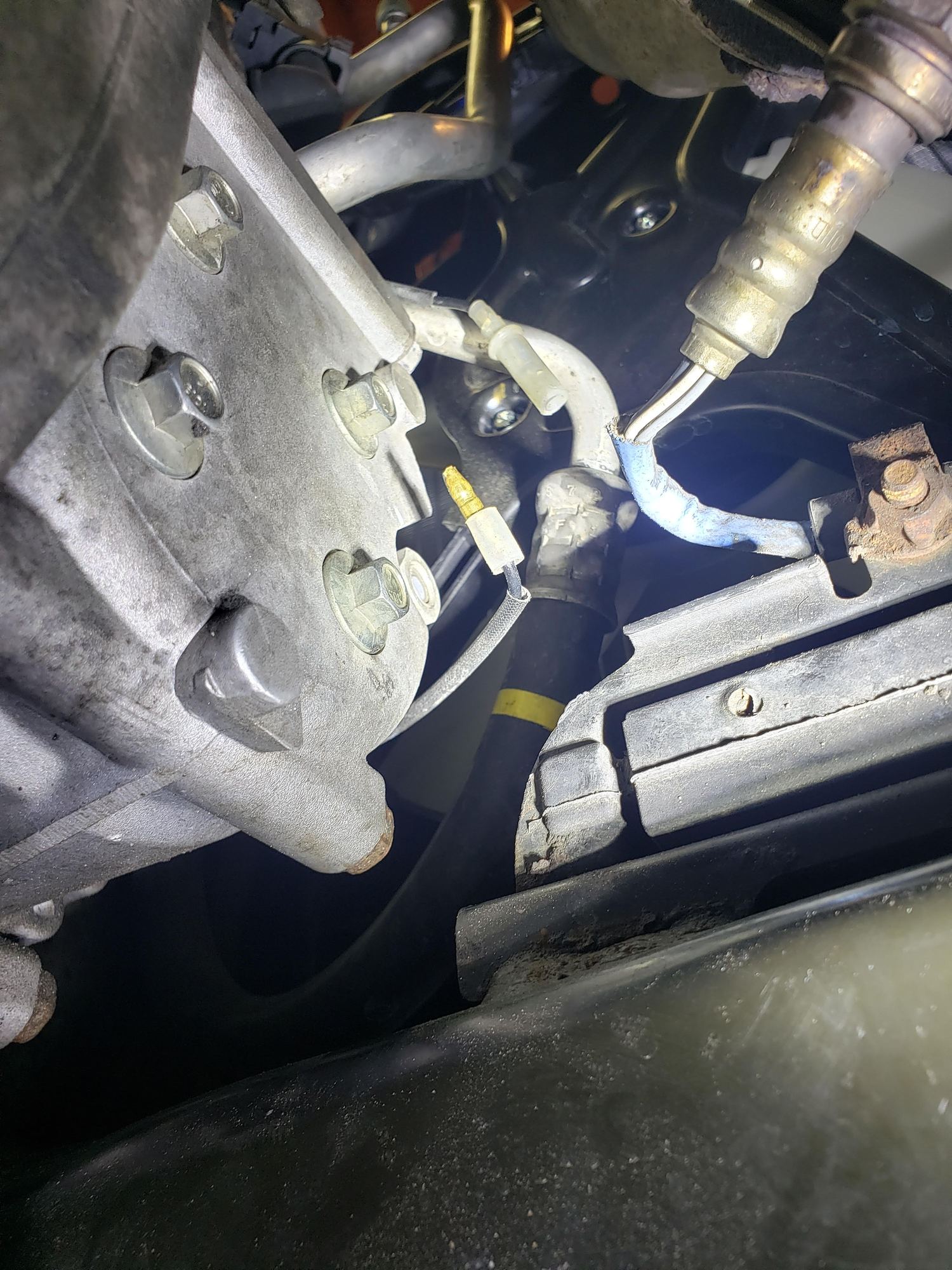

First of all, sorry if this is the wrong place to post. Currently have no AC, condenser fan does not turn on when AC is pressed, all fan levels etc. Heat works fine. A bit of context, I replaced my radiator as well as both fans several weeks ago. Havent had any AC since then, it worked amazing before. I'm sure I broke something taking it all apart. I have attached several pictures of what I think and hope the issue is, but feel free to let me know if there's other things I can do. I checked all connections to fans etc and it seems fine. There is a wire (pictured below, it's the black one) that goes to the AC compressor below the alternator. It seems to be broken, I'm not very knowledgeable with electrical stuff so I am pretty lost once I see wires. I've attached several pictures of the general area and other things for context, the black wire has been the main area of my focus so I'm hoping someone can tell me either how to fix that, what its called to replace it, or anything really summer is beginning here and no AC will make for a very grumpy girlfriend lol! Thanks in advance!

Yes, that is important. It looks like a bullet style connector. Try plugging it in.

Yeah just looks unplugged
