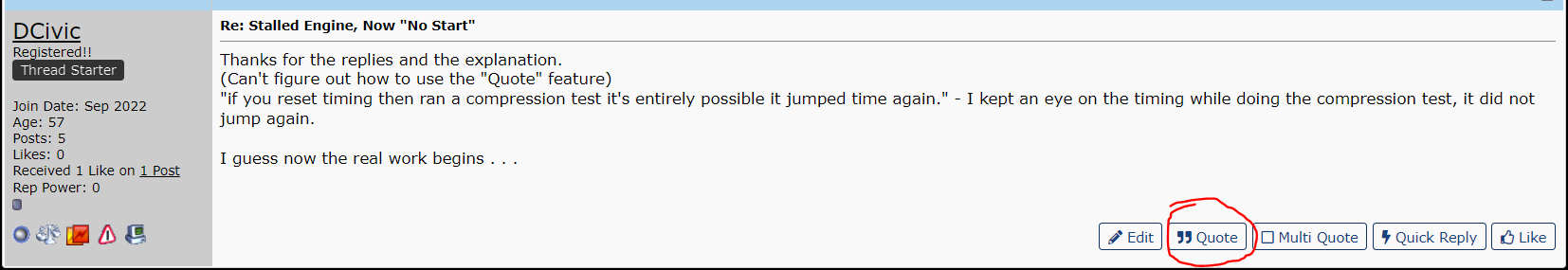

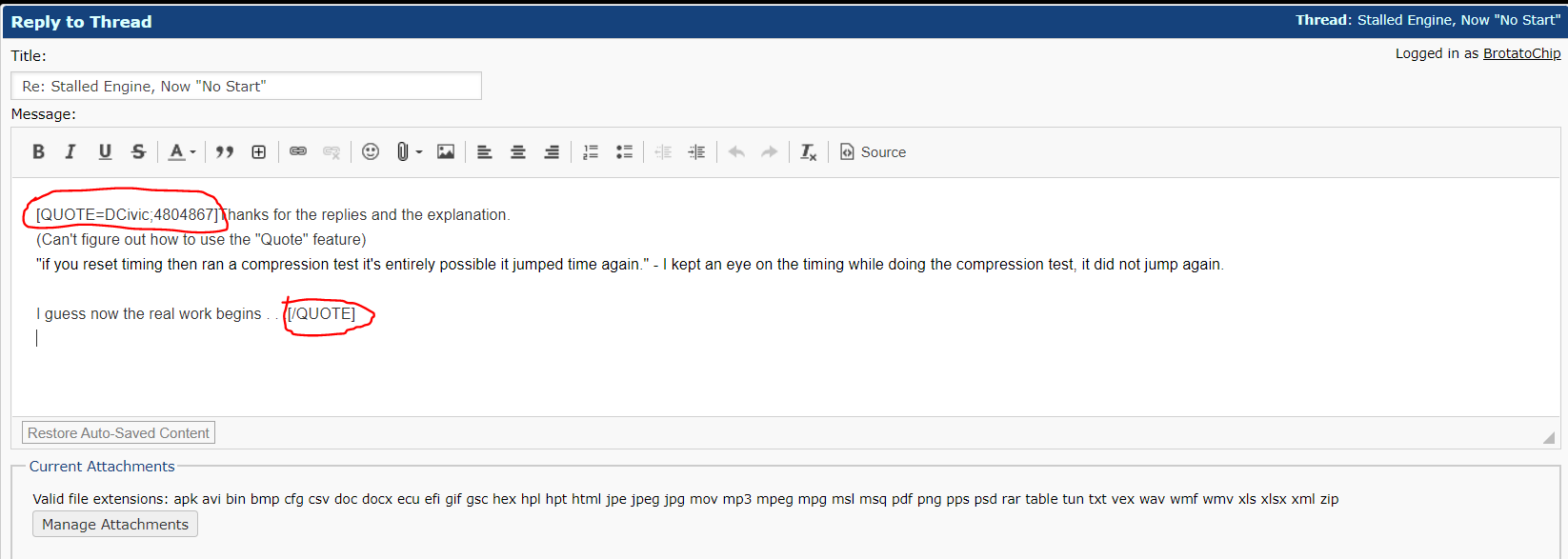

If you have any more questions feel free to ask. For future use....
Originally Posted by DCivic
(Can't figure out how to use the "Quote" feature)
Click the "Quote" button at the bottom of whatever post you want to quote. There's also the multi-quote button for multiple posts at a time.
Anything between the two circled square brackets will show up as a quote in your reply. In this case I trimmed out excess wording so the quote only shows what I want it to.
