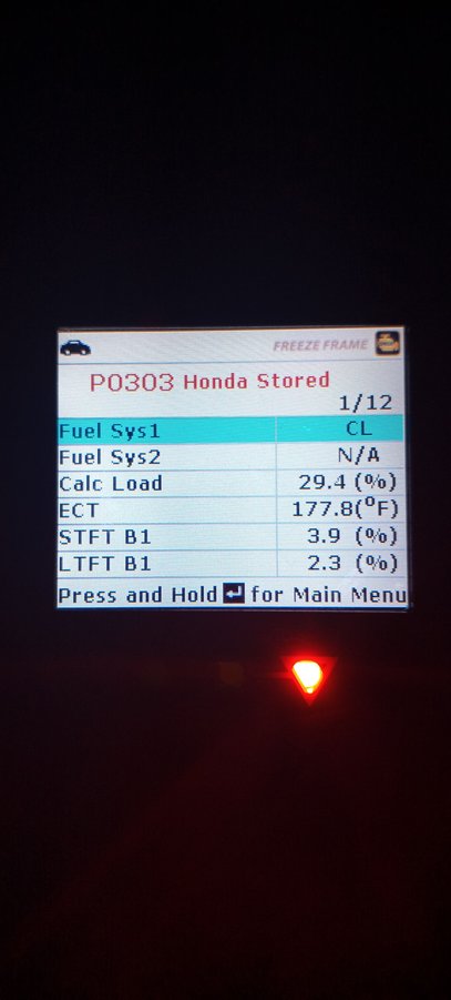

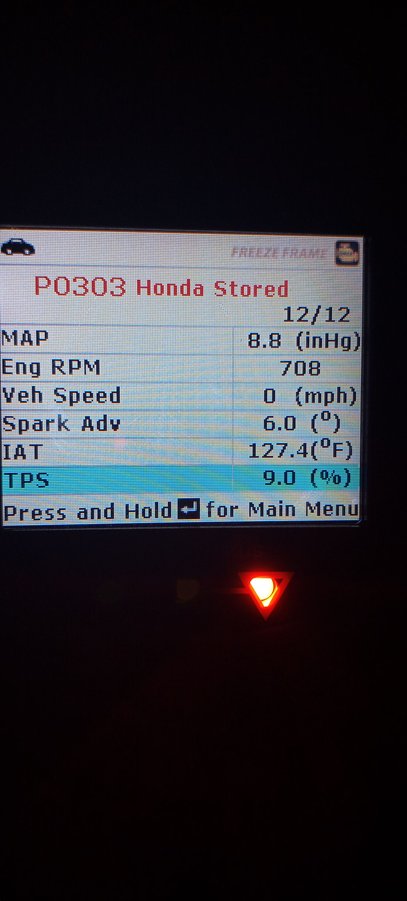

I noticed the ses light on after I put gas in. Can anyone interpret the freeze frame data for me? Anything stand out?

Rep Power: 225
Re: Crank no start - ideas
None of those values are worrisome.
