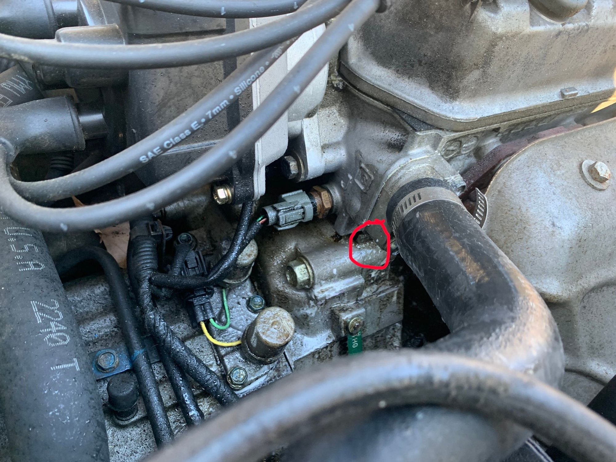

Looking for some coaching. This is my mom’s 2000 that has been a tank for her. She recently told me it’s dropping excessive oil in her driveway so I checked it out and it was over 2 quarts low. It appears to hemorrhaging in the lower front passenger side. I’m just getting familiar with this vehicle as it’s been a tank for mom and really hasn’t needed much over the years. I’ve attached a picture with the area it’s coming from. Cleaned it up this morning but it was difficult in the freeze we are in. I don’t think it’s the valve cover gasket. Any pointers to get me moving in the right direction are greatly appreciated.

Vtec solenoid can leak pretty bad on the back of the head and run down to there, or distributor oring.

Thanks. Both seem like good and easy maintenance work. Would you recommend OEM or is Advanced/AutoZone safe?

Oem is best

I did the Vtech Solenoid filter/gasket (side) and also did the distributor o-ring. No bueno! Any other suggestions. It continues to leak after the engine is turned off. Vehicle is parked with the nose slight downhill.

Somehow out of the headgasket maybe? Not very common

redstorm411 - did you find the source of the leak?

The Vtech solenoid up top seemed to the the problem.
