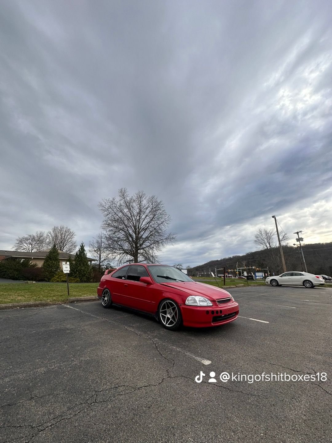

Hey all, to start I have a 98’ civic EX with the d16y8, bought it with auto to manny swap (S40). I’ve always owned shitboxes and worked on vehicles out of necessity, NEVER been to a mechanic besides tires and inspections. Used to work as a tech now I work maintenance at a foundry, by no means a mechanic. Recently rebuilt a 1980 Honda cx500 motor successfully, stripped bike to the frame just for some background. I’m not afraid to do work and want to learn just lack experience and lack anyone to teach me. My lowest skill set is electrical work. I bought this as my first project, since I’ve bought it I’ve overhauled the entire suspension, all truhart and moog parts, replaced my dizzy and spark plugs about 2 weeks after buying it, refreshed interior and that’s about it. Anyways…
