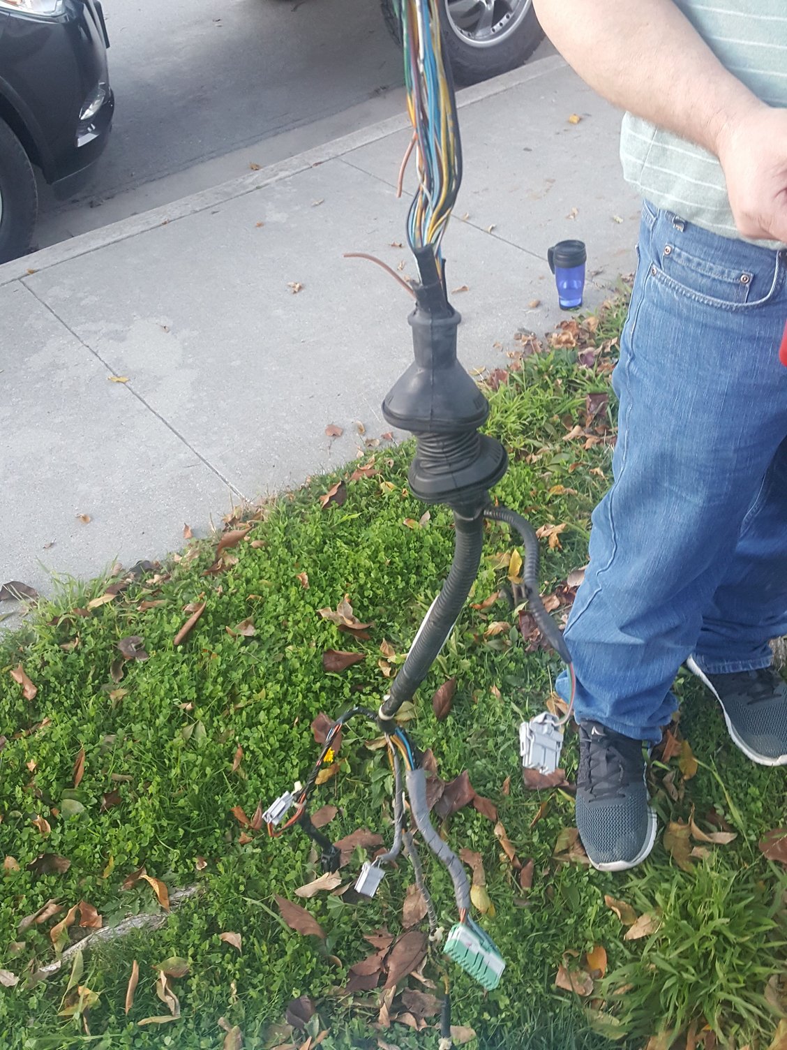

Hello everybody thank you again for all your replies and especially for that video that really helped it turned out to be the driver side Loom see the picture and yes I also got a new window motor and regulator and then everything worked thank God! Thanks again so much for all the help again
