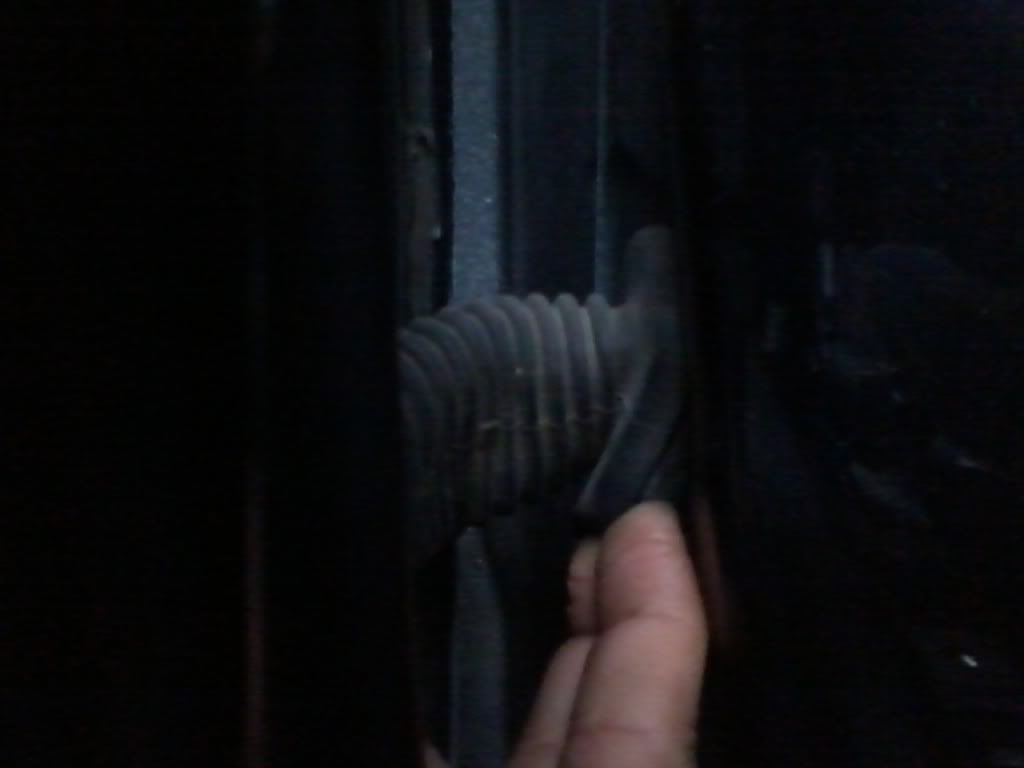

First, check the hinge boots. It's usually the driver's side. If you do find a broken wire you'll have to decide whether it's easier to run a new one thru the boot and splice it in right below the switch (master switch- driver's door, slave- pass door) or disconnect and pull the harness back thru to the interior and repair it there.
It's a tight fit but, you should be able to just fit your hand:
Sorry about the fuzzy pic, crappy phone cam.

OK, i checked the boots and i didn't see any broken wires. I actually took both fenders off to gain better access and there were no signs of damage on any of the wires.

Thanks lazong, you were right the first time. I finally got some free time and got to troubleshoot the thing and It turned out to be a wire that got disconnected from the harness thats outside the door. Now i wish i would have checked out those boots a lot better...it would have saved me hours of frustration and taking the car apart .
