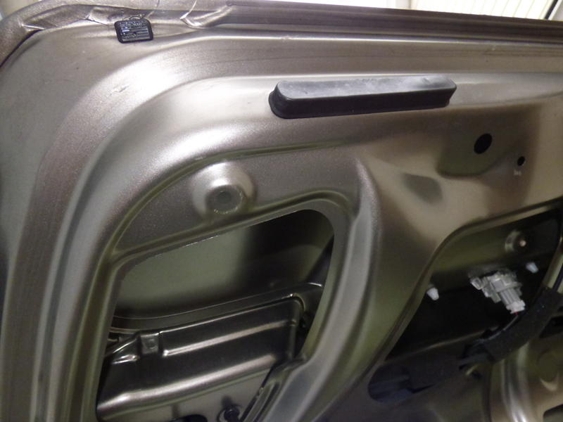

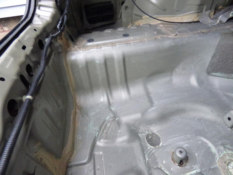

Same setup here on my 06 HCH.
I was backeneded in 2012 - about a 3 mph bump - caused $1100 bumper skin replacement - at dealers body shop - found water in the spare well after heavy rain thanksgiving 2013 - not sure how it got in there, so I dried it up and put paper towels in with the spare - found water in the spare well again march 2014 - The body repair is also out of warranty when I first noticed the leak - it rained and snowed again yesterday when I first read this.
I went out to double check my trunk. It was bone dry until I opened the trunk lid - then I saw a trickle of water drip down the trunks back bulkhead and pool in the spare well - I took some pictures yesterday.
I already had my trunk liner removed so I had the trunk open for a few minutes while I pulled out the spare than snapped a few pics.
My two guesses so far are
1: the trunk lid vent - that little rectangular black plastic tab in the upper left corner of the second pic above and to the left of the big rectangular trunk lid rubber bumper.
2: behind the bulkhead frame where the trickle seemed to start after I opened the trunk - but that seems less likely to me then the trunk lid vent leaking into the trunk when I open the trunk lid.

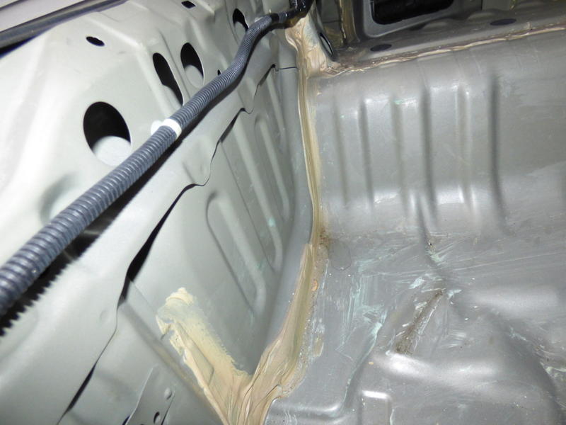

I've been tearing my hair out trying to figure out where the water in my trunk has been coming from. Having a constantly fogged rear window is pretty annoying.
I have only observed water in the spare well and usually stagnating on the drivers side right under the trunk vent. One day I set up the hose right over the rear window and flung the back seats down to see if I can detect any leaking. I saw nothing.
Finally tore everything out today and had a good look. Sunroof drain tubes look nice and clear and rubber feels soft but no cracks. The only thing that looks suspect to me is this badly rusted out bolt on the rear drivers shock?
Passenger side looks fine
Any ideas?

You would probably be best to focus on a leaking rear window.
You could also add more urethane to the metal seams in the trunk well in case the water is coming from the spray of the wheels or under the car.
The bolt on the shock tower is normal IMO.
