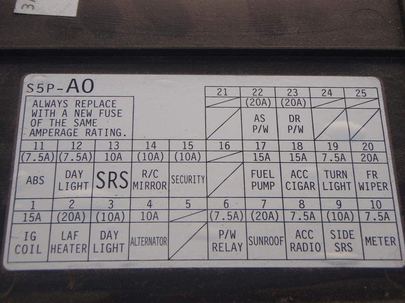

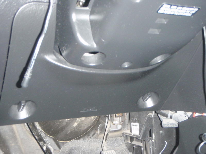

yea thats the one. theres supposed to be a whole cover under the steering area and on the inside of it there is a diagram showing what fuse does what.
i took a pic of the cover im talking about, its got two twist type clips that hold it in place. i also took a picture of the diagram on the inside of that particular fuse box. hope it helps you.

Oh yea I have that cover...just nothing on the inside of it...not sure why
