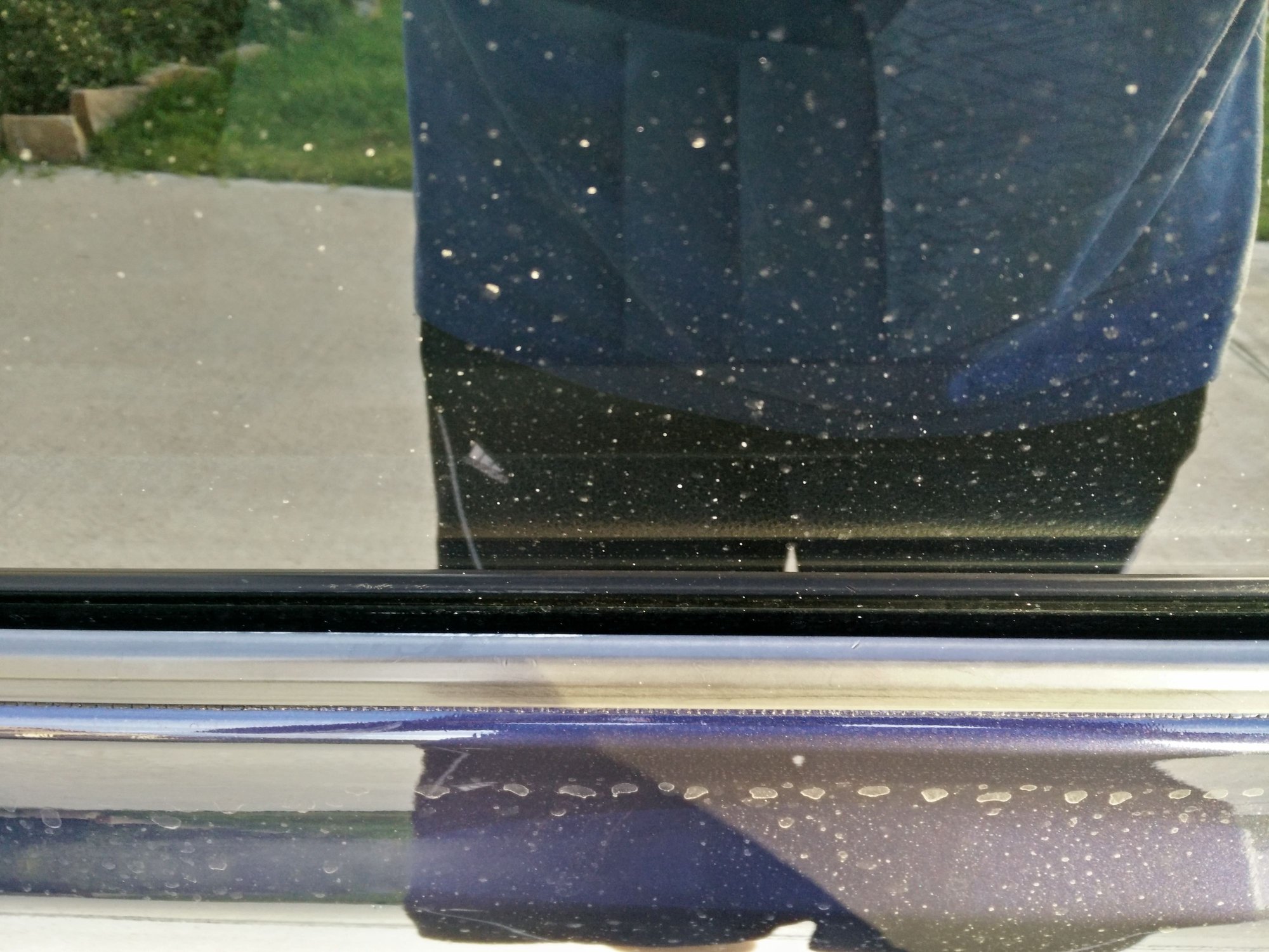

As you can see, the rubber shields that keeps the water from dripping are gone. It happens on both doors, and both doors are missing the rubber piece between the window and the door. Check the spoiler for pictures.

The doors are designed to allow water to pass through them. There are drain holes along the bottom edge.
If you have water dripping out of the door panel, it's probably missing or damaged vapor barrier behind the door panel. Vapor barrier is simply a plastic liner stuck to the door to cover the big holes and channel water away from the interior (much like a rain gutter).
Many workers trash the plastic when working inside the door and don't understand why it's there in the first place.
Anyway......the trims you are looking for #1 and #3?
In your catalog link it's listed under
interior/bumper > molding
