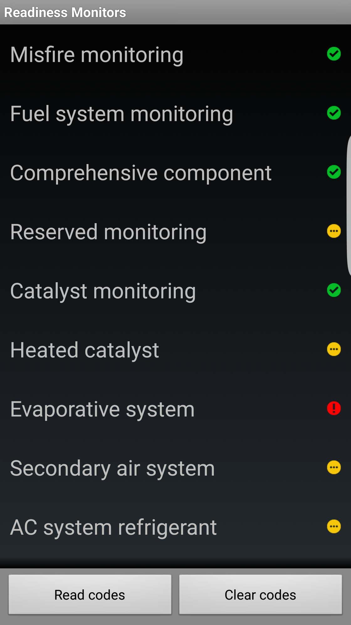

Guys I'm looking for some help please I have a 2005 Honda Civic I replaced the purge valve canister I've replaced the charcoal canister and solenoid at the back and the front spent approximately $400
after doing the repairs I've done multiple vehicle drives on it cold starts approximately 400 km and every time I run the test on my OBD2 scanner the emissions evaporative system just comes up and read it with no error codes so I'm under the assumption that a full drive cycle test hasn't been completed on it but after doing 400 km on it what more do I need to do I've done local driving I've done highway driving I'm just kind of at a loss I need to get this test done so I can get my car in to be tested any help would be greatly appreciated thank you

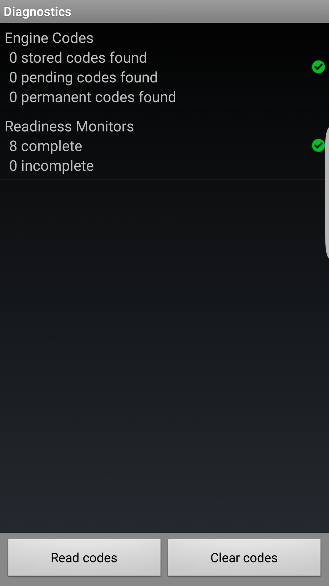

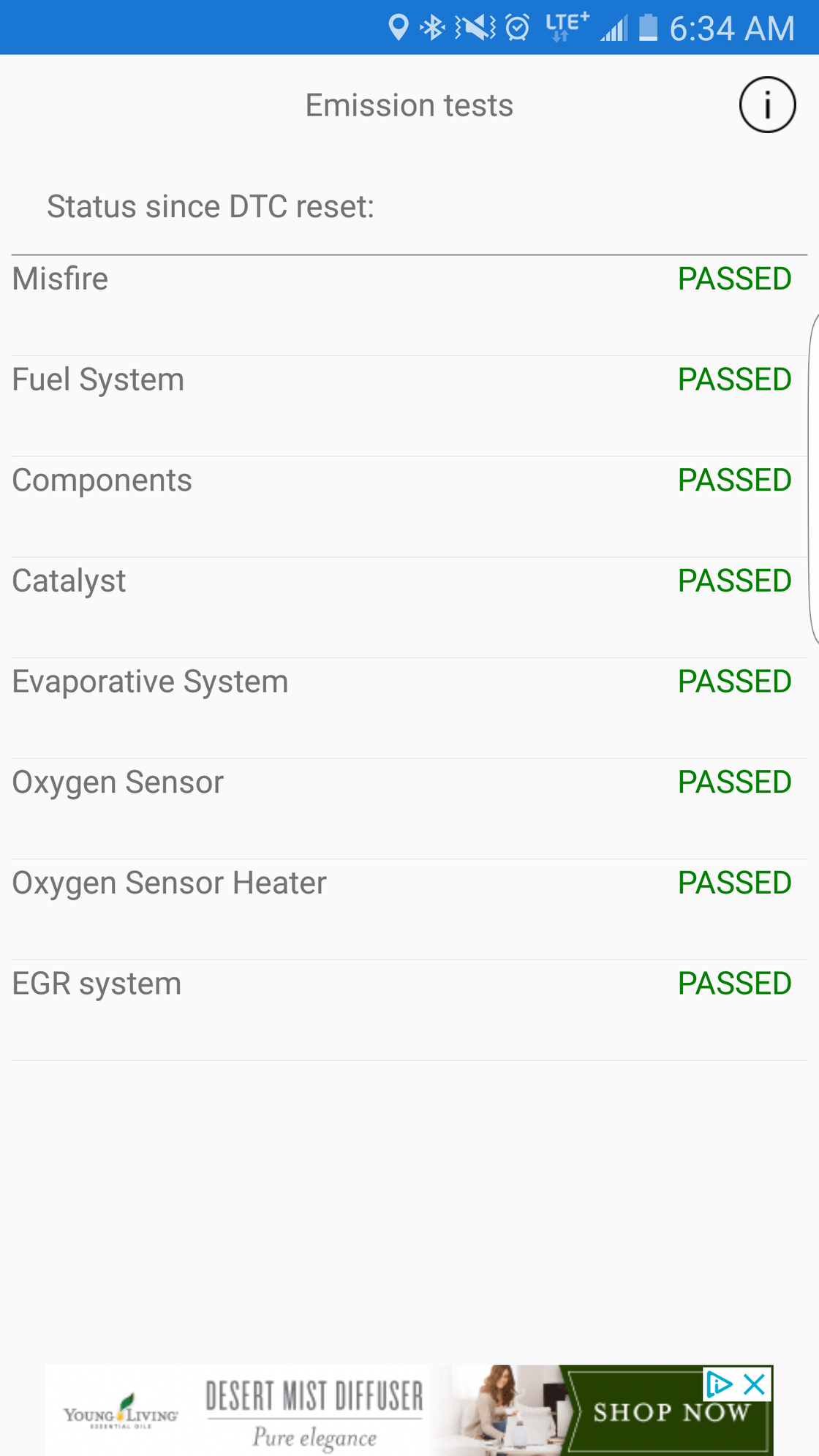

I did what you said the engine light did blink 5 times I've still don't know what that means but I drove to work and parked my car redone a check and as you can see by the attached photos everything passed thank you so much for your help and greatly appreciate it thank you..... maybe I should also mention when I read the test when I park my car at that time the engine light went on solid and then just went out as it should.

so i suppose it was the gas cap?
Old Jun 4, 2018
Re: Drive cycle test
Go get your emissions test taken care of before something goes wrong LOL
