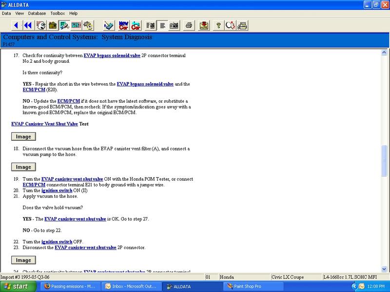

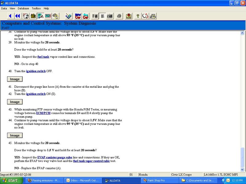

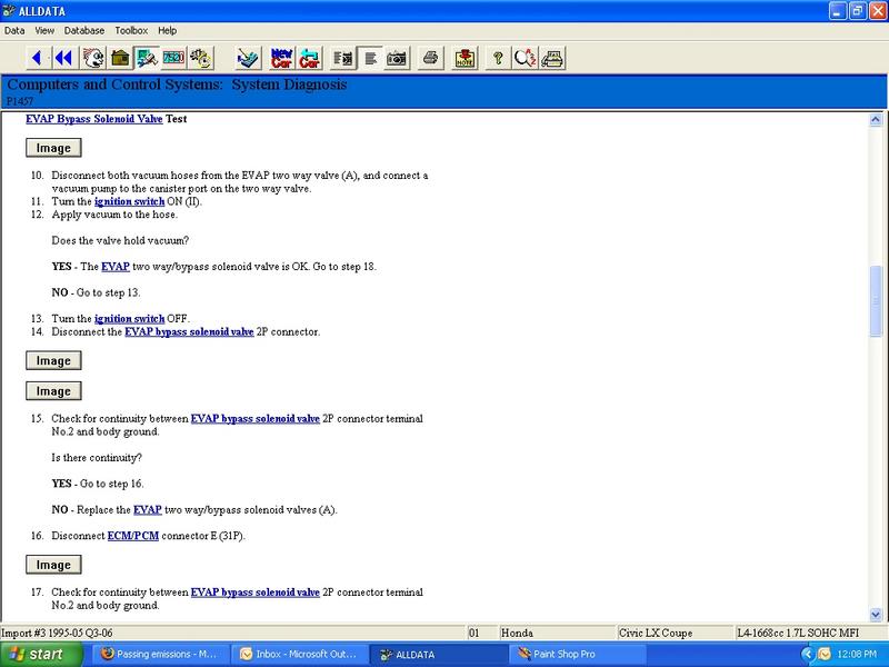

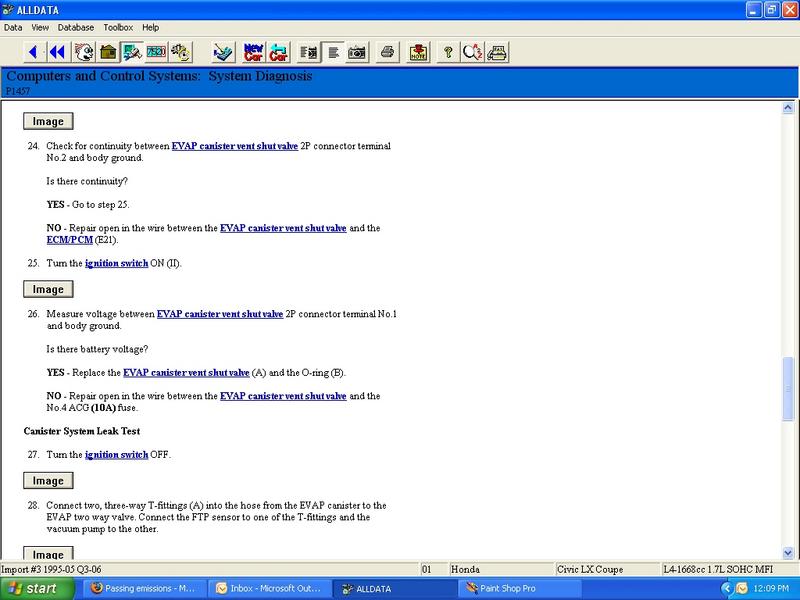

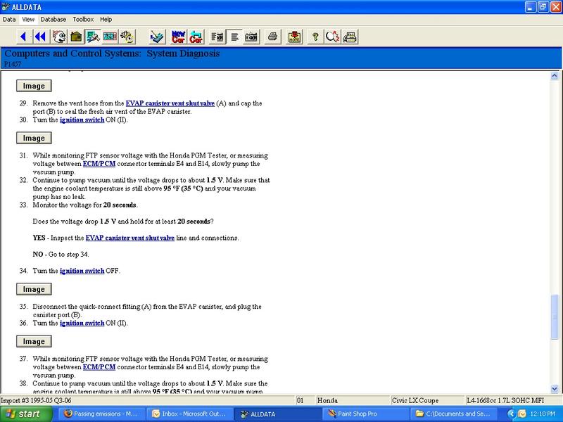

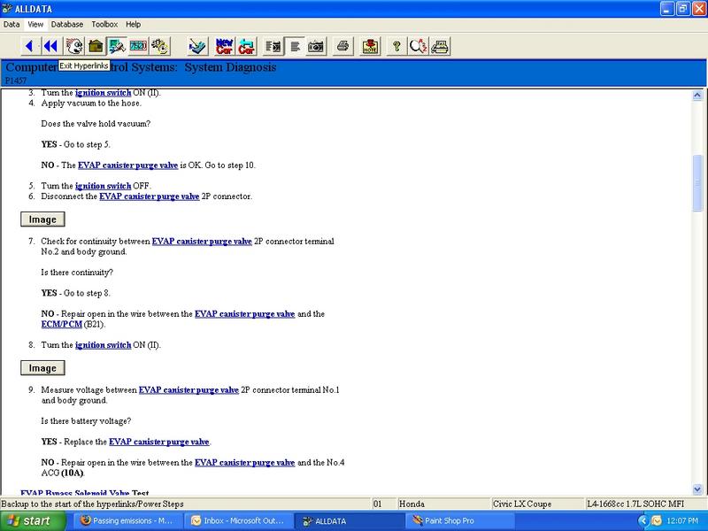

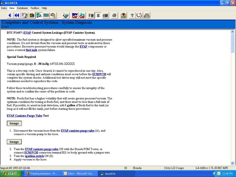

Re: P1457
Here is the flow chart to check i have pictures if you want to tell me what number of the test picture you need.
