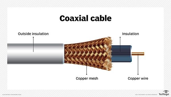

*looks at wire diagram
Your two wire colors were what, green and blue?
I think your wiring is still not right
The blue wire HAD a braided wire shield (google 'COAXIAL CABLE'), that's a shield and it's grounded....and it cannot be touching the inner wire!
The shield is to prevent RF interference on the signal line in the center.
That center wire is the only part of the set that can be connected to the sensor.
The shield wires cannot be connected to the sensor wire.
I figured it was a shield and separated it. But I guess maybe its touching somewhere else farther down the line. Ill have to check it again for the millionth time, thanks for the reassurance!
