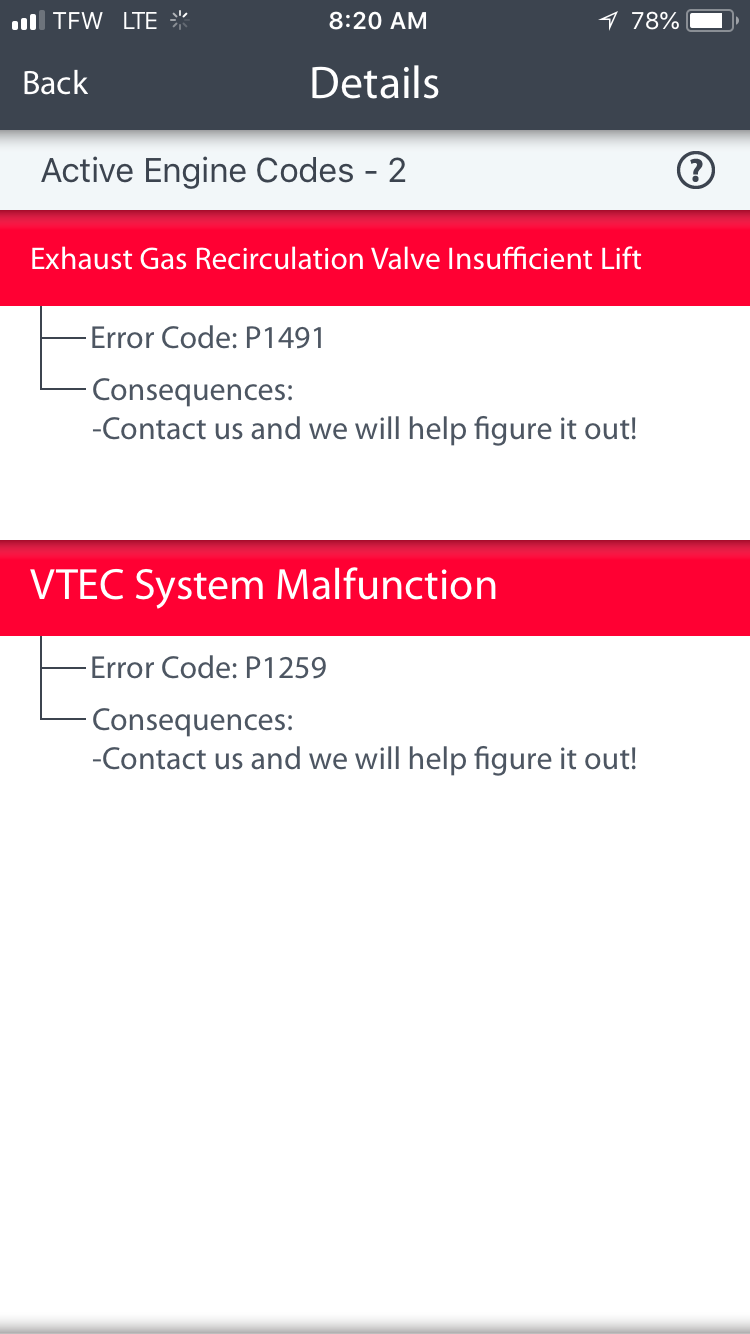

Ok so still didn’t get anything done with the P1259 issues. I’m a terrible procrastinator and it’ll probably hurt me in the end. I did plug in a code reader my uncle has, it’s a FIXD Bluetooth code reader. I’ve included a screenshot of the freeze frame data that it showed. Code P0401 changed to P1491, anyone else thing I’ve killed my EGR valve?

Re: Need help with P1259 code
P1491 and P0401 are both valid codes, but if one reader says one thing and another does not, then at least one reader must be lying to you....which ain't good if you're sent down the wrong diagnostic path.
P0401 is low flow
P1491 is insufficient lift (opening)
Also, I don't see any freeze frame data. Just codes.
P0401 is low flow
Yeah it’s not the best reader but it was all that was on hand at the time, that’s the only logs it will show. Gonna go to advanced auto today and have them read the codes and I’ll get pics from there. Until then I’m uncertain on which code to trust.
