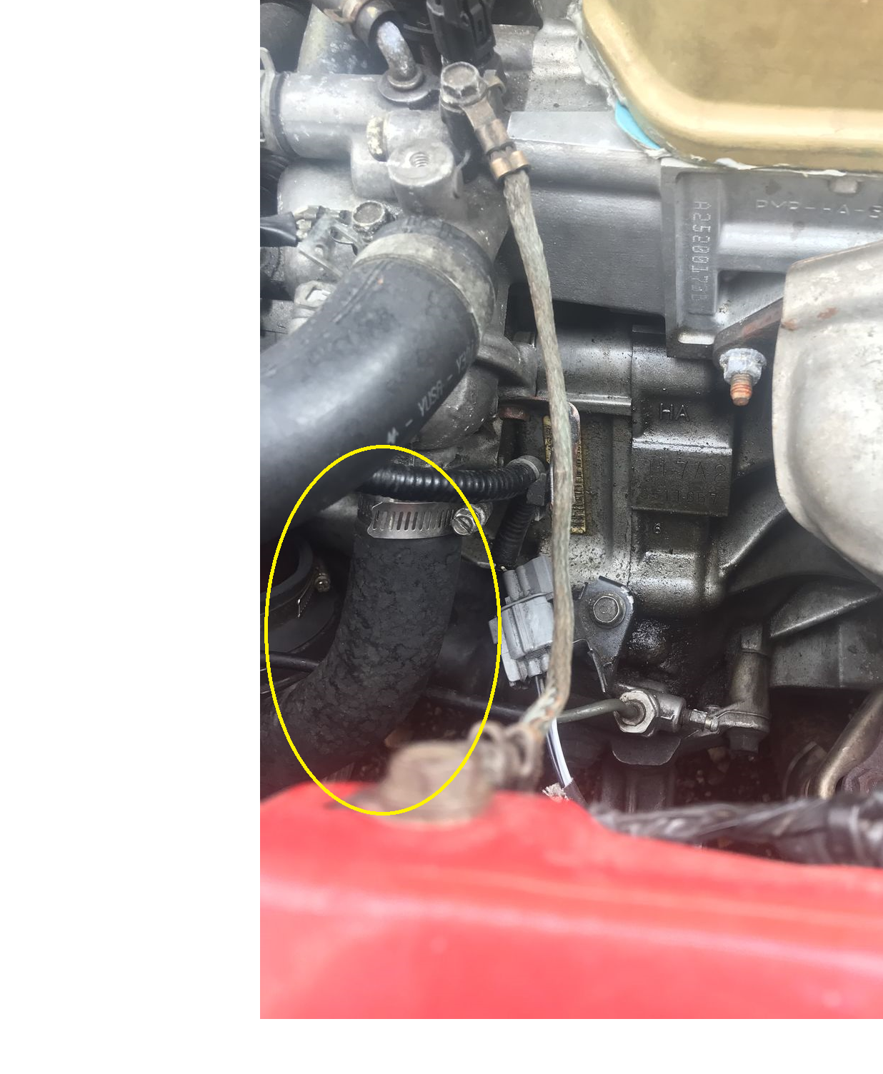

Here are the pics I gathered. Some might not show everything but it’s the best I could get without removing half the intake. Also I looked on the back of the solenoid a lil more and could see a drop of oil so I have some suspicion that it might be time for a new one. Front of motor @ stamp
Near the rear of block
More rear of block
More of stamp
More of stamp
Just noticed, could be nothing but it seems to me that there should be a bolt or something in there. I’m sure I could be wrong but couldnt hurt to know
Old Mar 25, 2018
Re: Need help with P1259 code
Gold painted valve cover + YUUUGE WADS of gray goo hanging out + blue gasket? Hack job! Installer was borked LOL (did you buy this from a kid?)
Cam plug leaks also end up running down the front of the bellhousing/block area
Ignore that bolt hole. Wasn't used in that car.
You took pics of where the leakage ends up.
Find where it begins!
(Much like finding a pond and wondering how it got there, never looking for the stream that feeds it)

Is this hose ready to burst? Looks bad to me from this photo...
