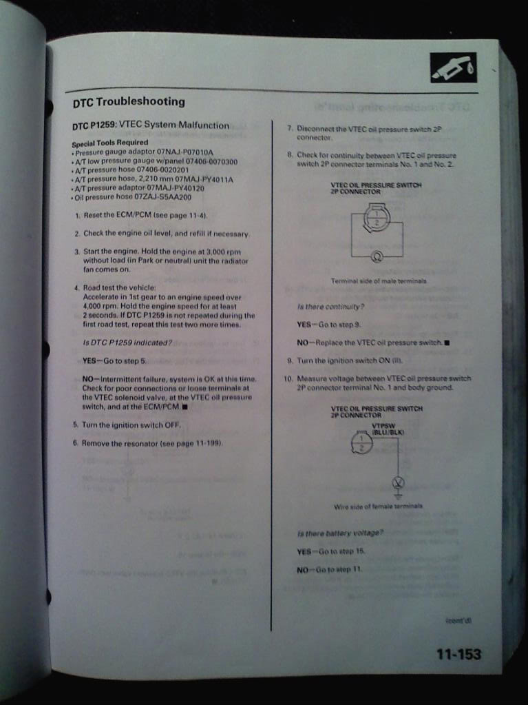

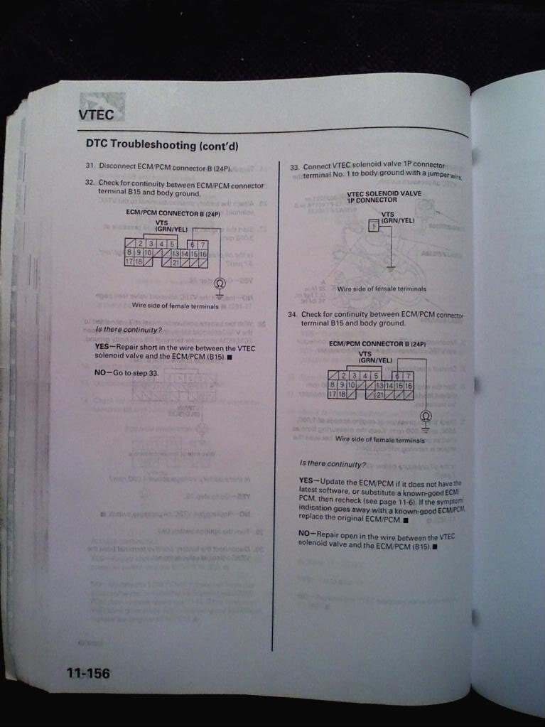

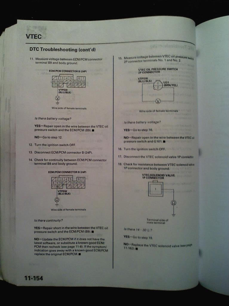

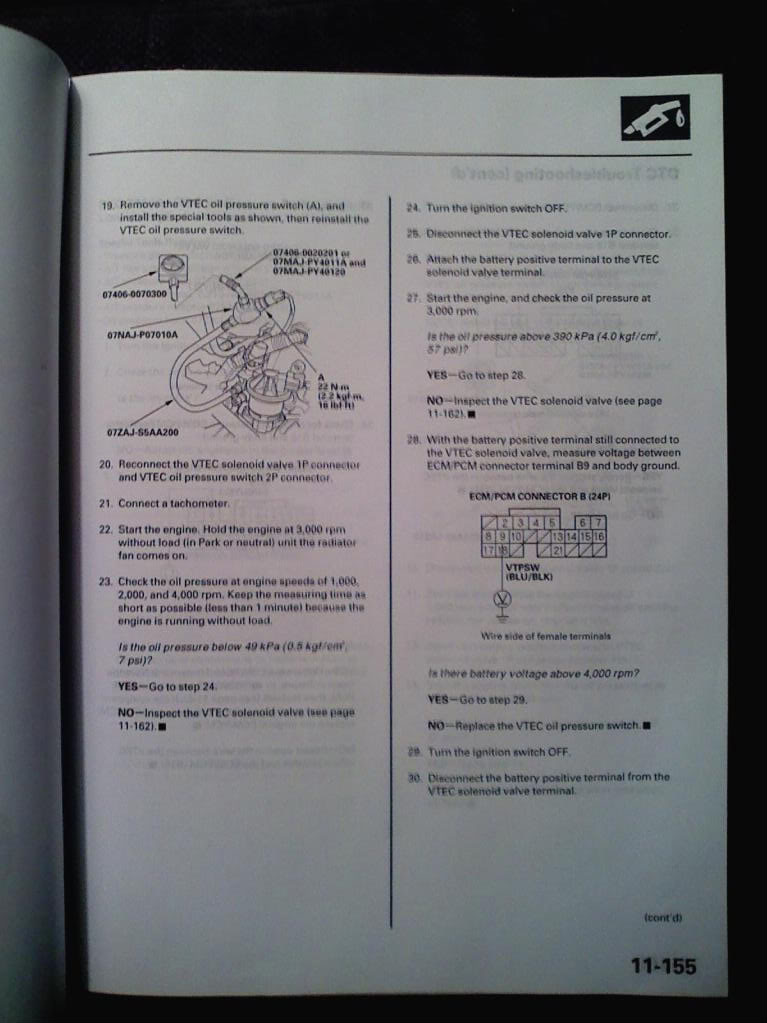

Try clearing the code. Drive it around for a couple days to set the drive cycle(s) then check for a code again. If no code, get it inspected right away. If the code comes back:

Sorry about fuzzy pics, phone cam.

Thanks, I'll clear the code today and see if it comes back. I appreciate the pictures.

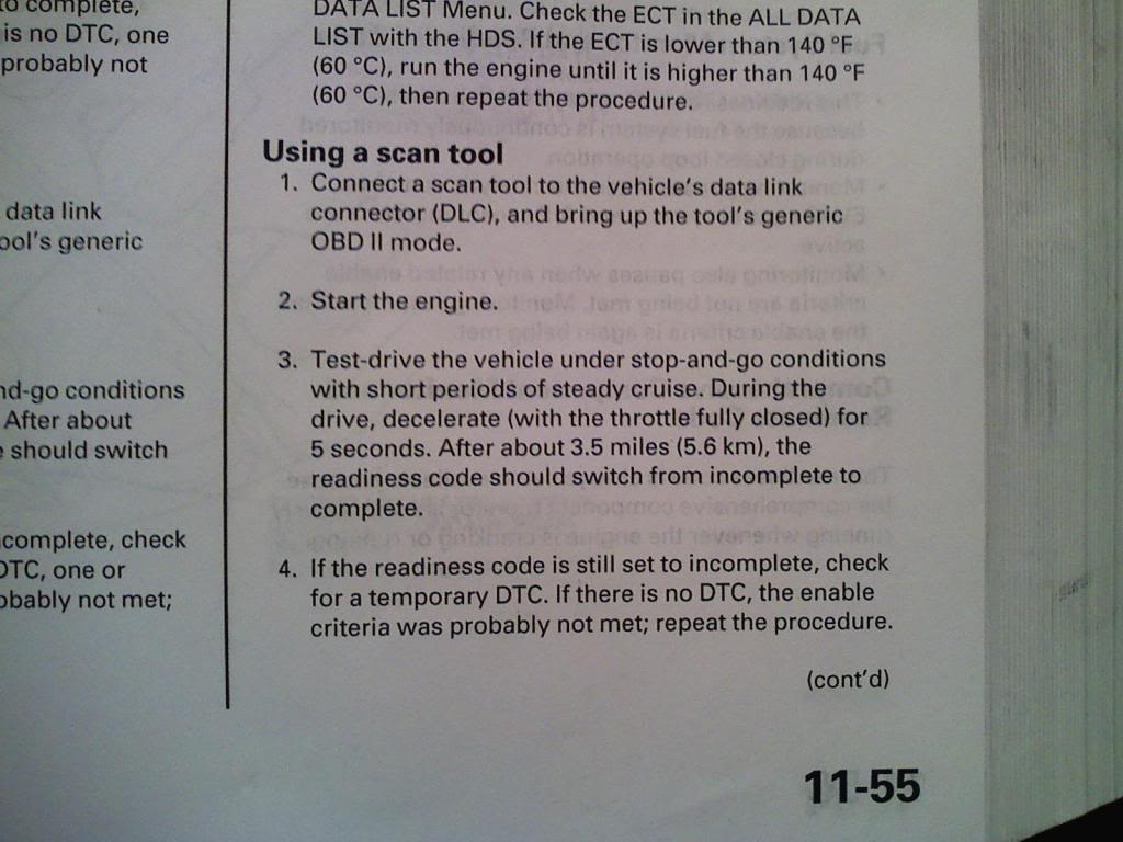

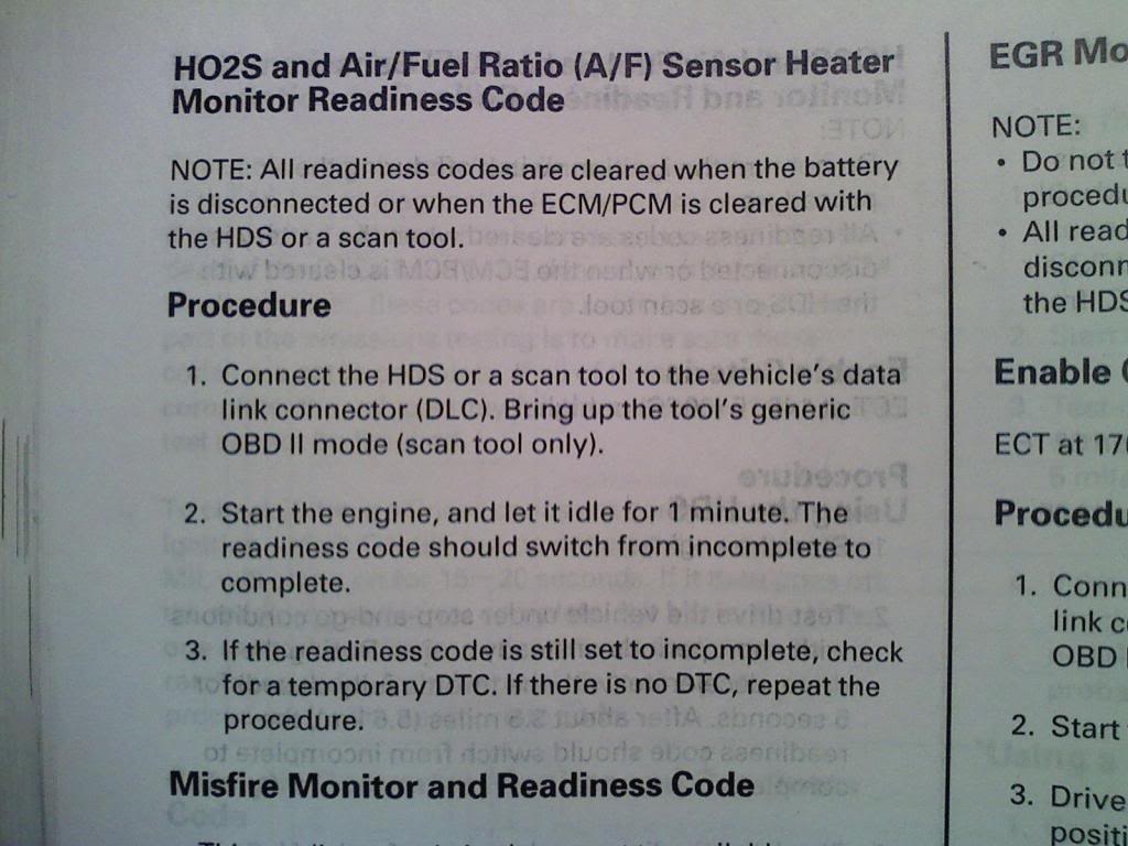

One week and no CEL. I'm still waiting for the secondary air system monitoring to complete. I've driven about 150 miles since I cleared the code, could something else be wrong or should I just wait for it to complete? I don't see any other failures.

Engine temp has to be at least 140F:

It depends on what state your as to whether all the readiness codes have to be set to pass emissions. I would ask an inspector or call the people who license the inspectors and ask them.

Thanks for mentioning that. I looked at the TxDPS site and it looks like I'm ready for inspection.
Effective October 15, 2008:
For vehicles year model 2001 and newer, we allow one (1) non-continuous monitor to be Not Ready and still pass the test, but two (2) or more Not Ready's will cause the vehicle to fail.
