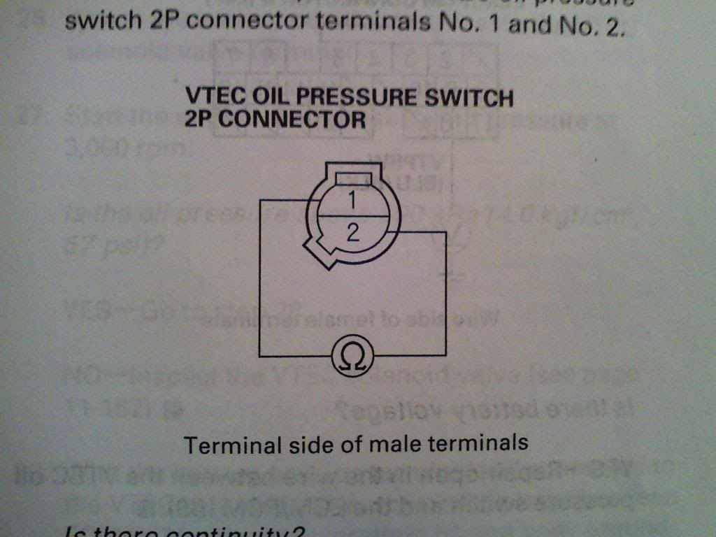

Low oil/oil pressure, or vtec oil pressure switch, or vtec solenoid, or vtec valve, or the vtec filter. There are several tests you can do before you have to disassemble anything.
You want to check the oil pressure switch first, It's this one:
Disconnect the 2P vtec oil pressure switch. Use a DMM (digital Multi-meter) to check continuity (ohms) between terminals 1 and 2 on the connector:
Is there continuity?
No- replace vtec oil pressure switch
Yes- I'll tell ya next step if we need to go there
