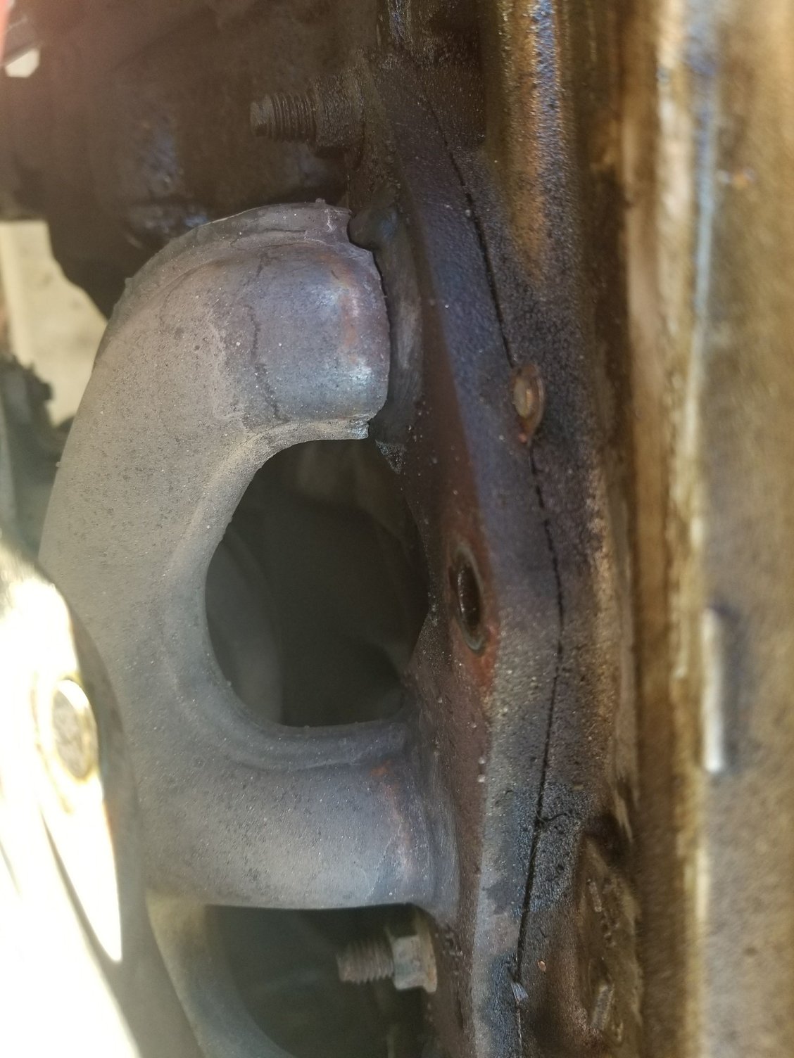

I've got a crack in the exhaust manifold... as predicted!

Anyways, holy crap, that's more than an exhaust leak, that runner (seemingly) separated from the flange.
Stupid question for you, when you say runner you mean the portion that runs from the cylinder head to the Cat? And the flange is the portion the flat portion that bolts to the head? And finally, my father in law is a gearhead and said if that apparent crack were actually the leak that the area would be covered in carbon. Thoughts?

yeah, gasoline is made of carbon molecules and other molecules that are released after the combustion process, so you will find carbon in there, as you would in any exhaust system for internal combustion engines. Not that it matters much, it's cracked, period. Heck, it's simply separated completely...
welding them does not yield long term solutions, they are connected to the engine, it will vibrate and crack again in the short term.
replace.
Thanks again!
Holy cow.....Did he see that picture, or is he blind?
The crack is pretty freekin obvious if a person has at least one working eyeball.
FWIW the flange is blackened with carbon.
Run the engine and you should be able to feel the exhaust pulses at that crack, and smell the rich aroma of fresh raw exhaust
