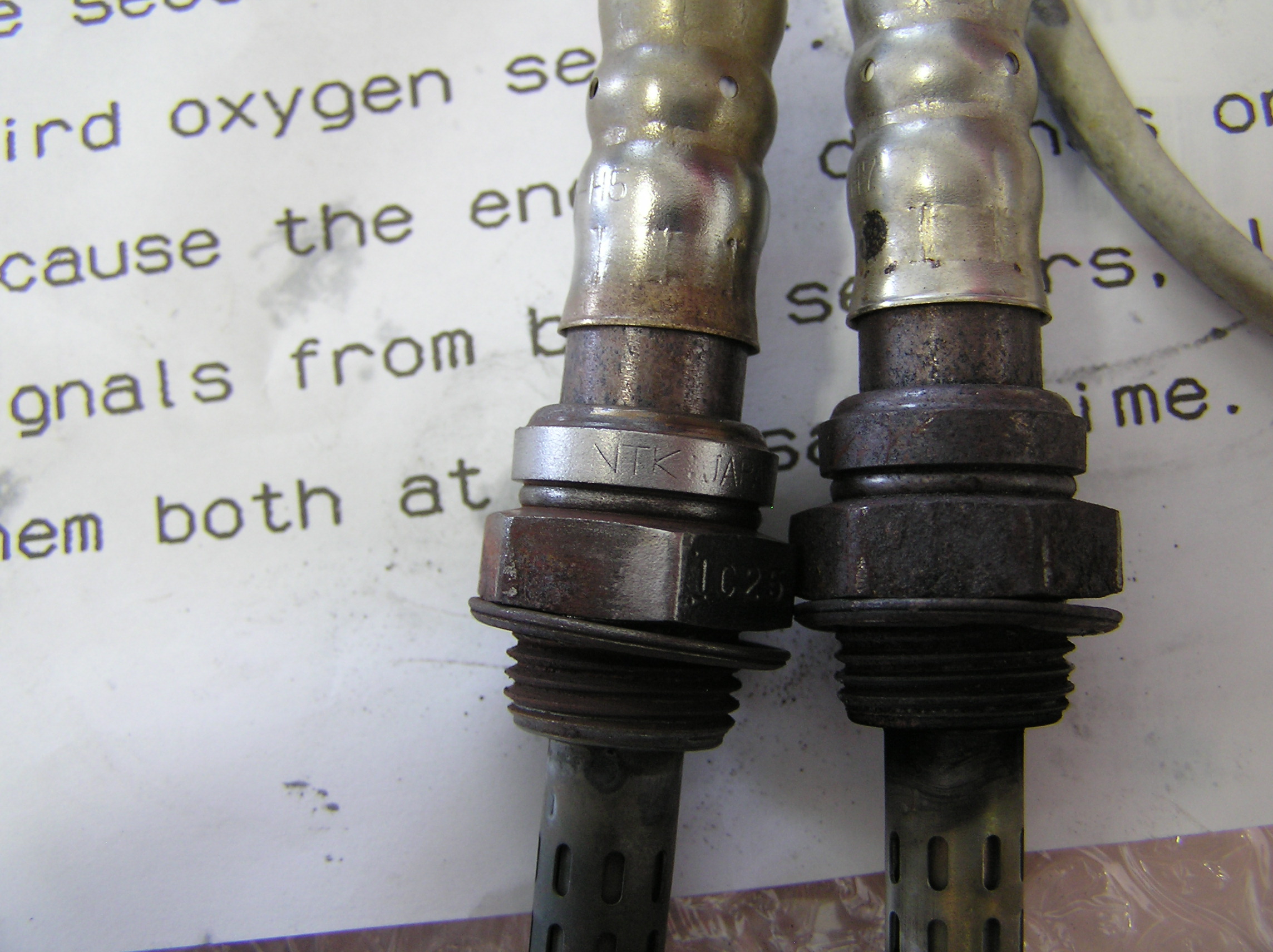

You don't have to go through a Honda dealer, but I strongly recommend you stick with the original brand of sensor.
Find the brand name on the sensor (it will be DENSO or NTK)...and you might have to remove it and use a wire wheel to find the brand name, then go to that manufacturers website and use their lookup to obtain a part number for your particular application.
Then search for that part number.
EDIT: Your primary sensor is not a plain O2 sensor, it is an A/F sensor (sometimes called air-fuel ratio or wideband sensor), that's why it is not cheap.
According to the Honda parts catalog, California emission spec cars use one part number, 49 state cars use a different part number.
Brand name example---before and after using a wire wheel to remove rust, this NTK sensor was marked near the hex but I have seen brand names on the upper metal shell too:
