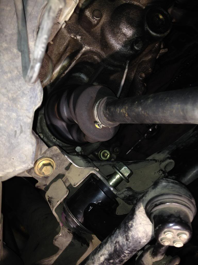

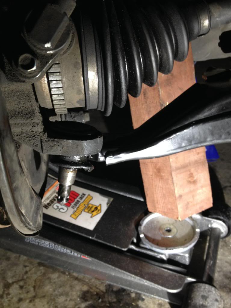

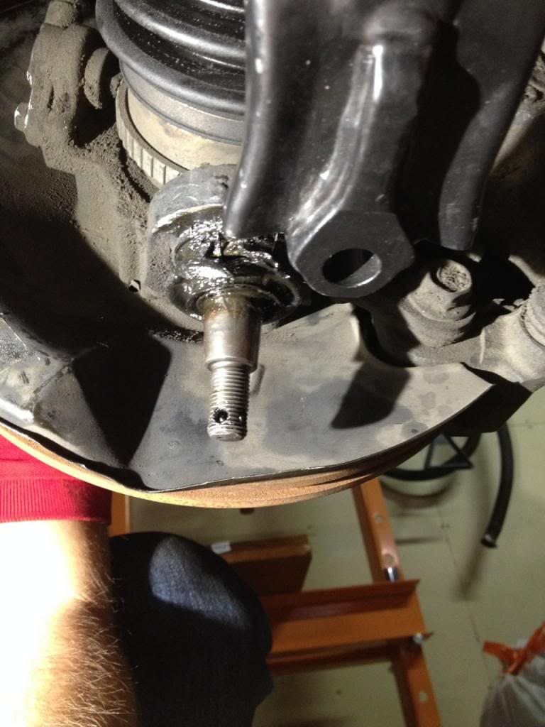

I like to live dangerously The front wheels are still in the air. I'll take a picture of the boot that looks weird.
The said pic

and the ball joint/LCA

money shot

Yep, definitely your Christmas came apart. Either do what ezine said, or take out to assemble it back, or get axles (what I did when I had a dead cv joint)

I've never replaced an axle but I have taken the hub off(removing spindle). If I were to replace it I would need to removing the spindle... How can I do that if I can't put the weight of the car on the wheels to break the nut(and no access to air-tools)?
Also, thanks for all the help! I think i'm gonna have a fun day tomorrow...
Old Dec 29, 2013
Posts: 15,190
Likes: 1,609
Re: 02' EX Lower control arm installation problem!
You don't need remove knuckle (spindle). But you might need place Jack under to remove nut.
Hopefully will work, never tried myself. Or try to blindly reassemble joint inside boot

Thanks for the reply ezone.
Is this an accurate picture of what is in there?
http://honda-tech.com/showthread.php?t=1954131
Old Feb 5, 2014
Maybe.
Take yours apart and find out.
