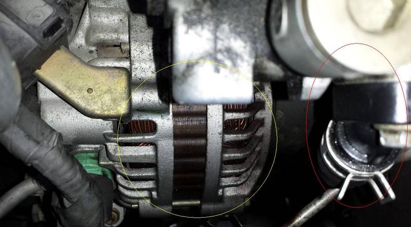

I've attached a picture.
Is that the "alternator" with the "coils" (yellow circle)?
That black tubing, is that the O-Ring (red circle)?
The Gunk Engine Degreaser? Will it work to spray and in there and wash it off after 10 minutes?
Thanks!

Re: Honda Civic 2001 - Power Steering Fluid
Yes
You said you had a new O ring.
Does it look like that?
Where did you put this new O ring?
The O ring goes in the inlet fitting on the pump. Item #20 here
If you put that O ring anyplace else, you better get it out of there before it causes damage.
Thanks!
Sure....I don't think I would wait that long though. A minute maybe, if that, and rinse it right out.

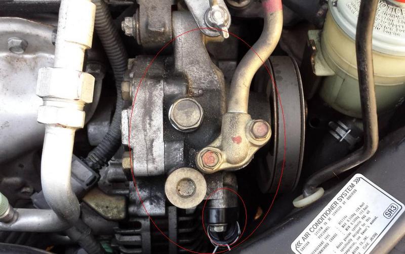

I've attached a zoom out picture.
The one in the big red circle, is this the pump? If not, what is this one called?
The smaller red circle is where I placed the new O-Ring.
If I take out this O-Ring again from the smaller red circle, what is the best way to drain out the steering fluid without getting it all over the alternator? Is there another method to drain out the steering fluid?
Thanks!
That's the pump.
There are 2 #20s used.
Cannot say which one he is talking about though.
Cover the alternator with an old towel.
It looks to me like one of the #20 is internal inside the pump, the other is in the inlet fitting..
My bad, at a glance the first pic looked like you put it inside the hose or something. I actually thought the pic was the reservoir.
Still, there was an o ring in there that was to be removed before installing the new one.
I need a damn vacation.
