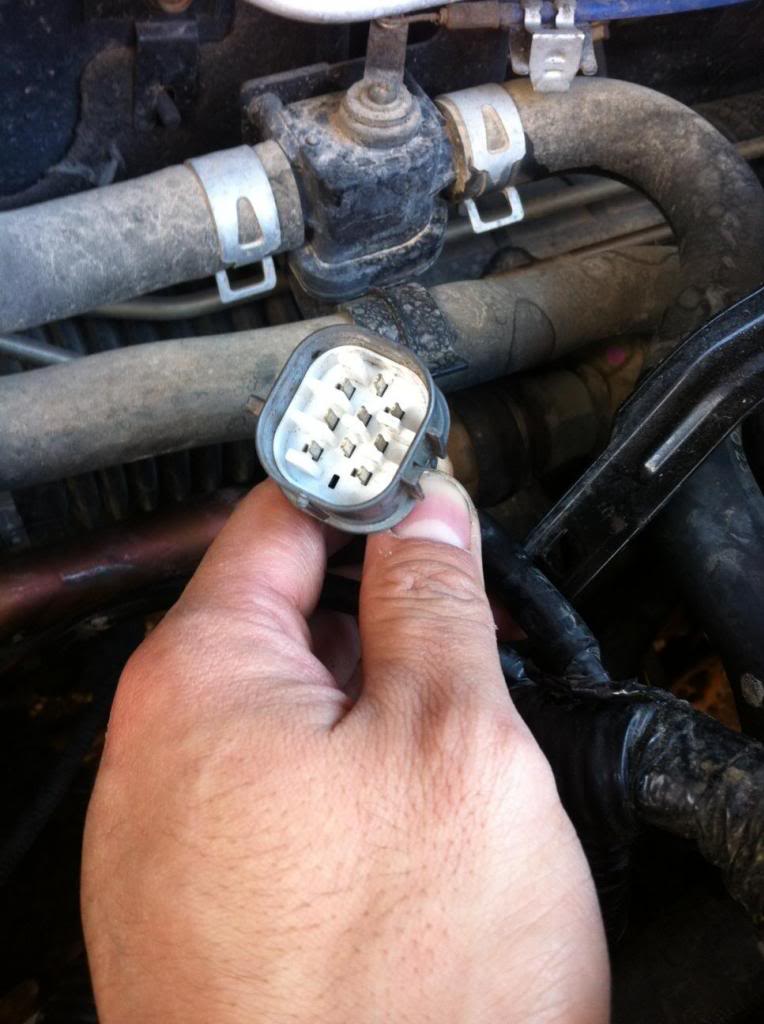

Okay cool. He is going to have to wait for now to do the Head converstion into Vtec. But for now I have a few other issues with the car. I put the motor in, I got it to where it turns over. I haven't fully inspected everything as far as spark and fuel, but if I were to take an educated guess :P I would say I have Spark and no fuel. Only when I started to turn it over I squirted a little starter fluid in the TB, and it almost started up but never did. It would only seem like it wants to start when I have starter fluid in the TB. Also I couldn't figure out if these plugs are the reason why it wont start. Figured I'd make sure and see where these goes before I even try starting it up again.
