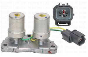

I believe it looks like this
http://www.transjobber.com/images/80425.jpg
Just did a quick google search.

isnt that the solenoid?

Re: Check Engine Light on!
That's not the TCC solenoid. That is the shift solenoids.
Again...The TCC solenoid is #4 here:
