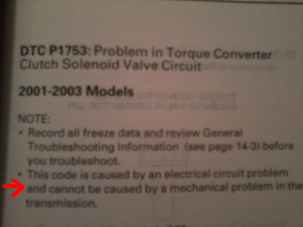

Re: Check Engine Light on!
FTM:
DTC P1753: Problem in Torque Converter Clutch Solenoid Valve Circuit
Note:
This code is caused by an electrical circuit problem and cannot be caused by a mechanical problem in the transmission.
So for this code only, you have an electrical problem, not a transmission problem.
HTH

That's for the torque converter solenoid circuit.
Either your mechanic is incompetent or he's straight up lying to you:
Post up if you can operate a multi-meter and I can tell ya how to diagnose.
