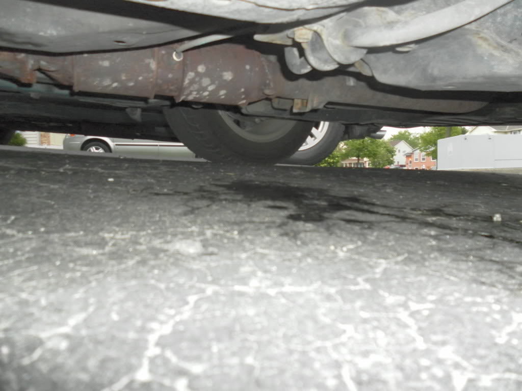

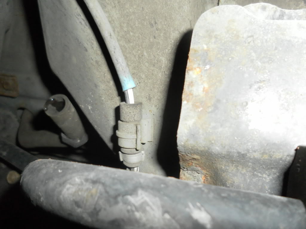

Hmm... got home from work today,came inside for an hour, went out for a smoke and noticed what seems to be a water drip coming the rear end of the engine, still dripping an hour later. It's dropping right near the catalytic converter. I can't see it from up top but it's very close to the back of the engine. First thing I thought was condensation from the AC system but I haven't used the AC in days... Is it possible to get condensation drip without using the AC system? My coolant level is perfect, and it's definitely not oil. It's water. It hasn't rained here for a few days either. This just kinda caught me off guard. Took my camera to where I couldn't see and I found this, odd... Not sure what it is but it's above the passanger side near the cat:

Important info: I was using defrost It almost seems like a hose that is designed to get rid of condensation... Any info on this would be great I'm intrigued!
I did some more research! Turns out our civics do have a drain hose .. it's part #22 here. I'm assuming that's what's showing in the picture... I guess I answered my own question lol... I should search before posting.. I know. I'm gonna leave this thread undeleted and see if it starts a discussion
