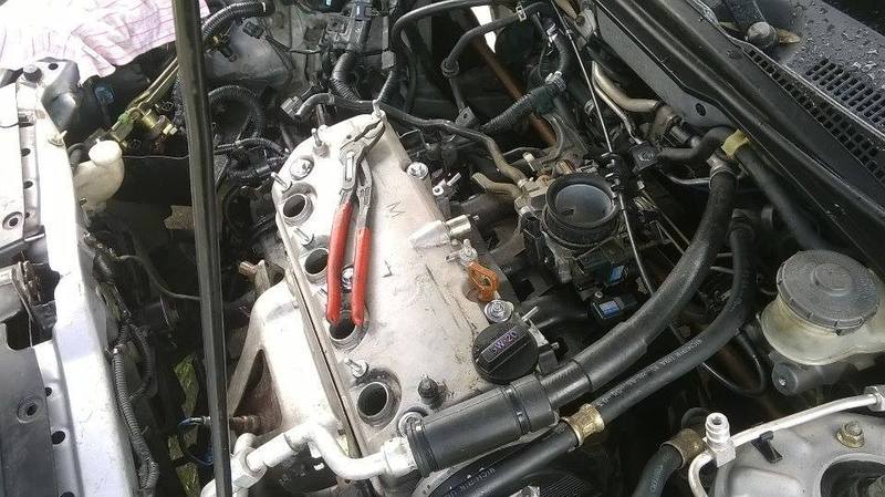

Thank you to everyone who replied. I did run the heater maxed on that 2 miles stretch but to no great avail. I guess what's done is done now. I will keep these tips in mind if it happens again.
My good friend came over yesterday and pulled the head for me already. He actually specializes on Civics. He had the car in pieces and the head off within 2-3 hours. The failure was in the very center of the gasket between the 2 pistons. He said it looked like someone did a patch job on the engine without getting the head machined. All of the gaskets, seals and timing belt looked new. The head came off the block "too easily". He said that is another good indicator that it was probably patched recently. I skipped getting the gasket kit since everything was spanking new. I didn't have the extra $$$ to opt for the kit so we just grabbed a new head gasket and some copper sealant. The head is out to the shop and now I just have to wait. I paid about $50 for parts, $50 for machining and best of all he only charged me $150 for the labor (we go waay back). The local shops quoted me up to 10x what I ended up paying.

Good to hear. Really helps to have someone that knows their way around a Civic engine.
Most likely the previous owner did not bring the cylinder head to a machine shop for resurfacing during the suspected head gasket repair and/or didn't clean the block surface off well enough.
Did you or your friend check the engine block for warping with a straight edge and feeler gauges? Very unlikely that the block is warped but, you never know unless you check, You can probably get away with the old exhaust manifold gasket but, the intake manifold gasket should be replaced... you might end up with an intake leak and extra work for not installing a $10 intake gasket.
Did your friend drain the coolant out of the engine block by removing the drain bolt in the back of the engine block? Doing that combined with draining the radiator through the stopcock or removing lower radiator hose is the best way to drain the coolant.
You're only getting a resurfacing at the machine shop? Did the shop check for possible valve seating leaks or bent valves? Are the valve stem seals in good shape?
I know you stated you are trying to save money (and who isn't?) on the repair but, at the same time you don't want have to do this again prematurely due to possibly missing important steps.
