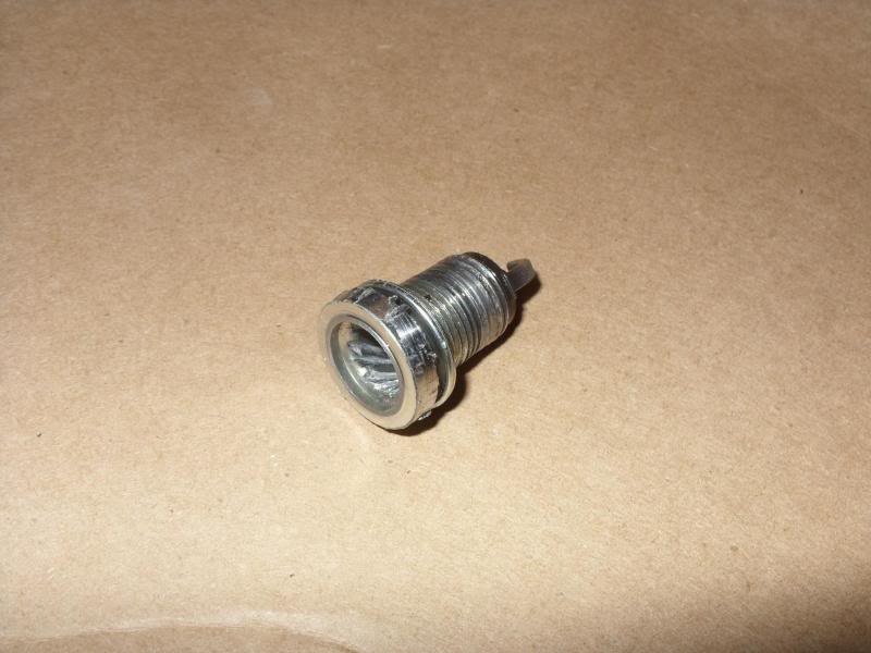

Well, the threaded portion of the spark plug is officially out of the head. I got a bolt extractor to do the job. The problem with the extractor is that the end of it is a square for a tap wrench. Well I needed it to get down to the plug, so I beat it into a smaller spark plug socket that I never use. Then an extension and the breaker bar popped it right out. The threads at the bottom of the plug are flat so I am thinking there is a cut thread near the bottom of the hole. So now for a rethreader.
Anyone used a rethreader? I assume it will refurbish the original threads, not cut new threads or make it perfect. I am thinking if the plug flattenend any threads then the rethreader will at least cut the flattened sections back to allow a new plug to thread in. Any thoughts?
And pics of the extractor and thread:
The scratches on the top are from the channellocks used to get the plug off of the extractor:
You can see where the extracor cut into the interior of the plug:

nice, craftsman makes a fitting that will hold a square bit on a ratchet, but you got it anyways so thats cool. Now you need to re tap the threads, flush the **** out as much as you can and your good to go. Most taps will somewhat follow the existing threads and start cutting new ones where the problem starts. I'm guessing its going to cut all new threads though - because you backed the mashed threads on the spark plug all the way up. They sell all sorts of different size die and tap kits so make sure you get one larger enough for spark plugs.

it might work if there is something to cut into, otherwise there might not be enough metal. you can prolly get it good enough to install a new plug tho.

From the look of the plug that came out, it probably left enough of the threads for you to start a tap or rethreader and clean up the old threads without cutting new ones. If you are able to clean up the existing threads be careful when you install the new plug. The repaired threads are probably not as deep as the original and you would definately want to use a torque wrench to be sure you do not strip what is left of the threads. Cleaning or cutting the threads will produce metal particles so clean well.
