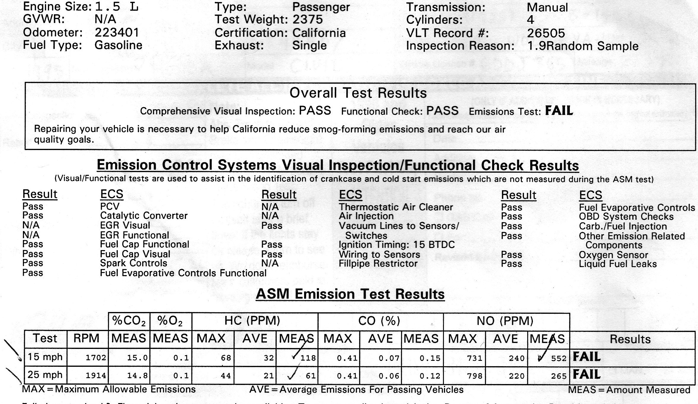

I have a 1995 California Honda Civic DX with 1.5L 4 Cyl D15B7 (223,000 miles). It failed test 1, with only hydrocarbons too high. [118 ppm instead of 68ppm at 1702 rpm/15mph and 61ppm instead of 44ppm at 1914 rpm/25mph]. Engine timing was 15 degrees.

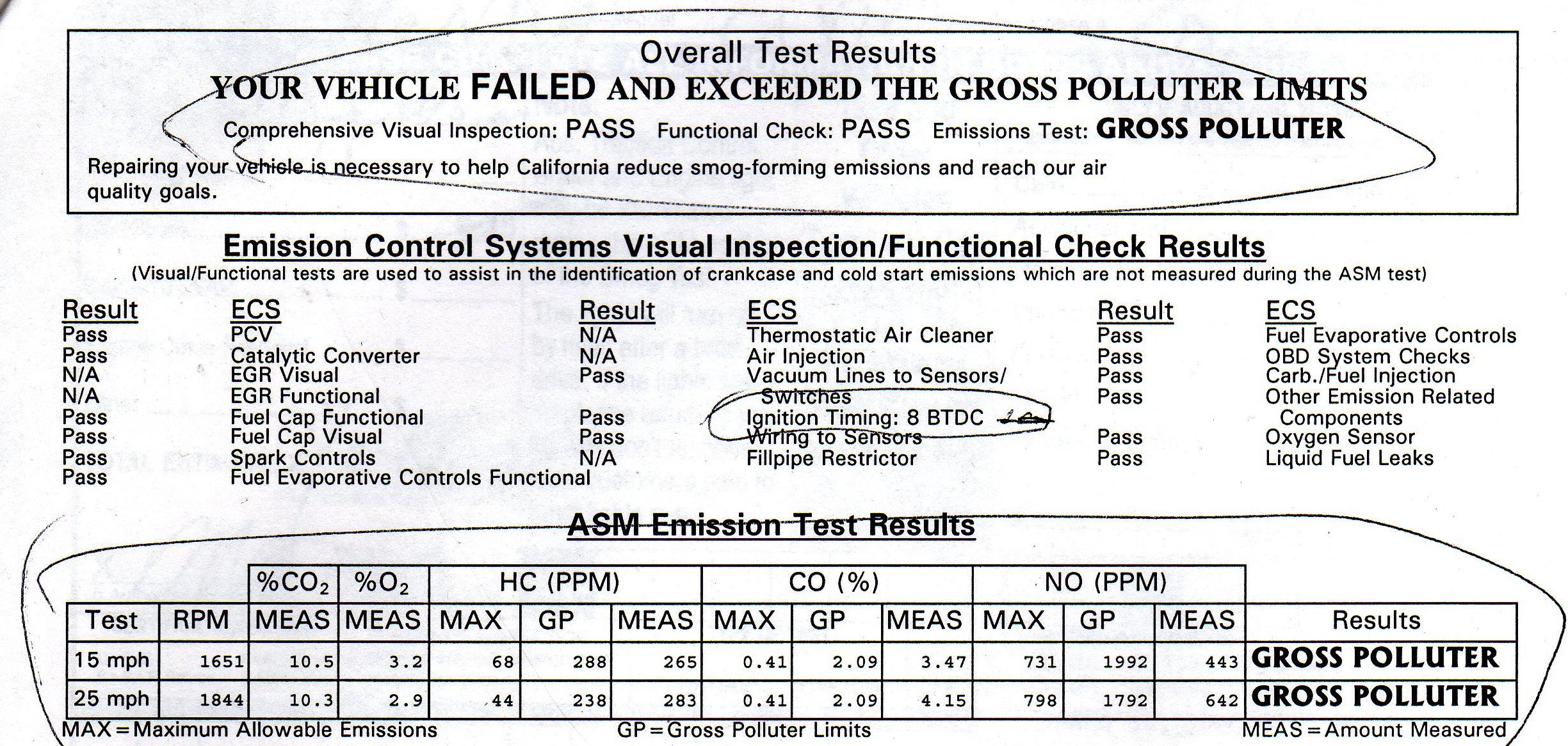

Hoping for a little improvement, I had the car smogged again. Bad news. Now I was a gross polluter. Engine timing was only 8 degrees. At 25mph, HC was up to 283ppm, and all the numbers were worse. For example, CO rose from 0.12 to 4.15.
I went home and checked the timing with a timing light, and it was 15 or 16 degrees. I had holes in the muffler and midpipe, which I taped up before getting the smog checks. I just installed new ones.
Could removing the Air Conditioning possibly hurt? What would make the timing change from 15 to 8 degrees during the second test, but be back at 15 later? Could the terrible performance during the second test be related to the wrong engine timing?
