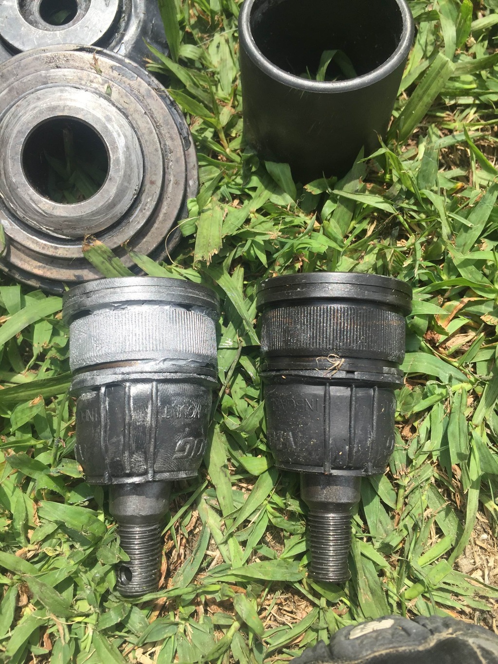

installing new ball joints
I was replacing my LCA bushings since they were torn and decided to replace the ball joints since I was in the area and they have 160K on them. I purchased a set of Moog ball joints which have a ring at the top with vertical ridges.

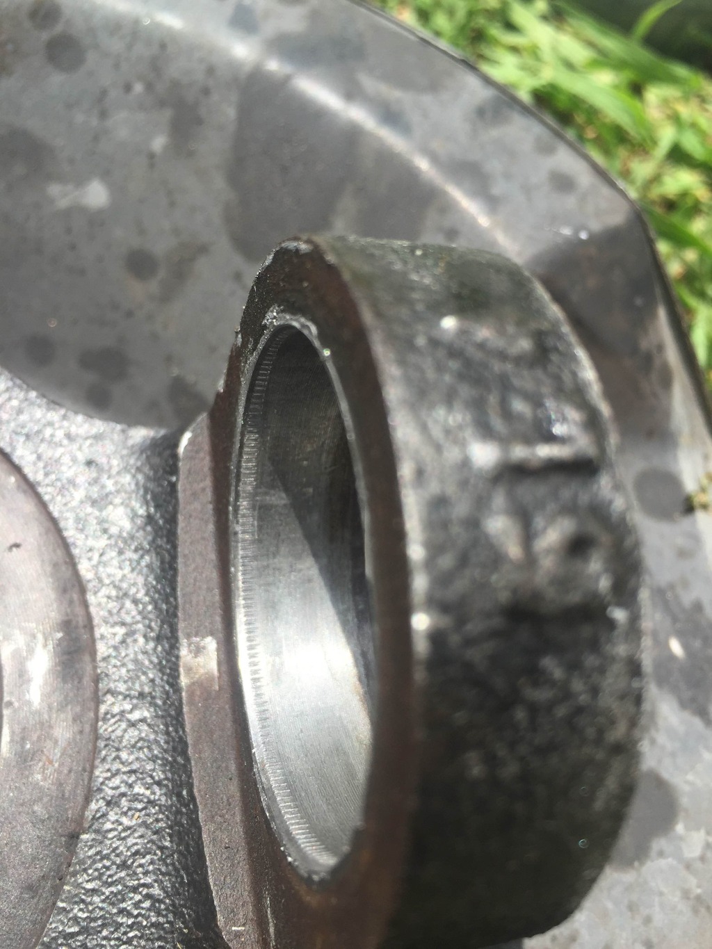

When I tried to press it in to the knuckle it moved a little bit and then was really hard to get any leverage on the ball joint. So I popped it back out to figure out what I was doing wrong. When I did I noticed the vertical ridges were digging into the knuckle.
Does this seem normal to anyone or is something wrong?

Do you have something to measure with like a caliper to check OD on the old as compared to the new?

Sort of looks like you got it in far enough that it was at the full diameter of the new part when you look at the grooves. Of course, it's going to groove all the way down which if you had a hydraulic press would probably be no big deal. Obviously a lot more than the original. Guess Moog errored on making sure they were tight. Years ago I was rebuilding my 69 Firebird and the aftermarket were so oversized, I had to grind a bevel. They were however pressing in a stamped plate and went. Since then I stick to OEM replacement parts for most repairs. You really need to get you a dial or digital vernier caliper from harbour Freight. Only $20.00. Usually on sale for $10.00 all the times.

you need to measure the hole before installing new ball joints,
read this thread....and read the service bulletin i have attached in that thread....(courtesy of ezone).....
https://www.civicforums.com/forums/3...nts-again.html

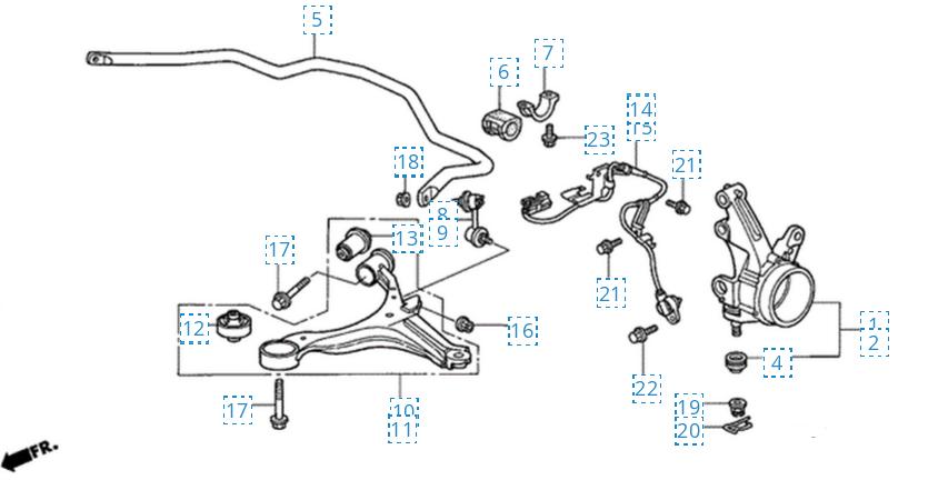

I am thinking real hard and since the wheel is on the ground attached to the knuckle, the car is pushing down on the lower control trying to pull the ball joint on thru the knuckle in the way it was pressed in from the top. On the rebound however like when the wheel is hanging, it would pull in the way of the ring. However, you are correct that the ring will keep it in place and the lower control rod going up till it bottomed out on the knuckle. However, it's not going to let the wheel flop out so long as the nut is on the ball joint. Could be one of those is the sky falling or is the ground jumping up. Also, I am just thinking and was wrong on a couple things over the years. This may take a NASA engineer. I am only a Nuclear Engineer
Name:	KNUCKLE 2002 CIVIC.jpg

Re: installing new ball joints
The lower ball joints are not weight bearing on this setup, the strut/spring carries the weight.
Even with that said, there is still a significant amount of force the ball joint is subjected to, and the interference fit between knuckle and joint must be able to withstand every bit of those forces.
IF the opening in the knuckle is worn enough that the ball joint slips and it must rely on a snap ring to keep it from going all the way out (or up, into the CV joint) then there is a huge problem and that particular ball joint should never have been installed in that particular knuckle.
Honda has an oversize joint listed in the bulletin linked earlier, along with a way to gauge the opening for the joint.
I've seen other situations where a joint did not fit tight in a control arm, the snap ring could not keep it in place either. I tack welded the joint to the arm in that situation.
