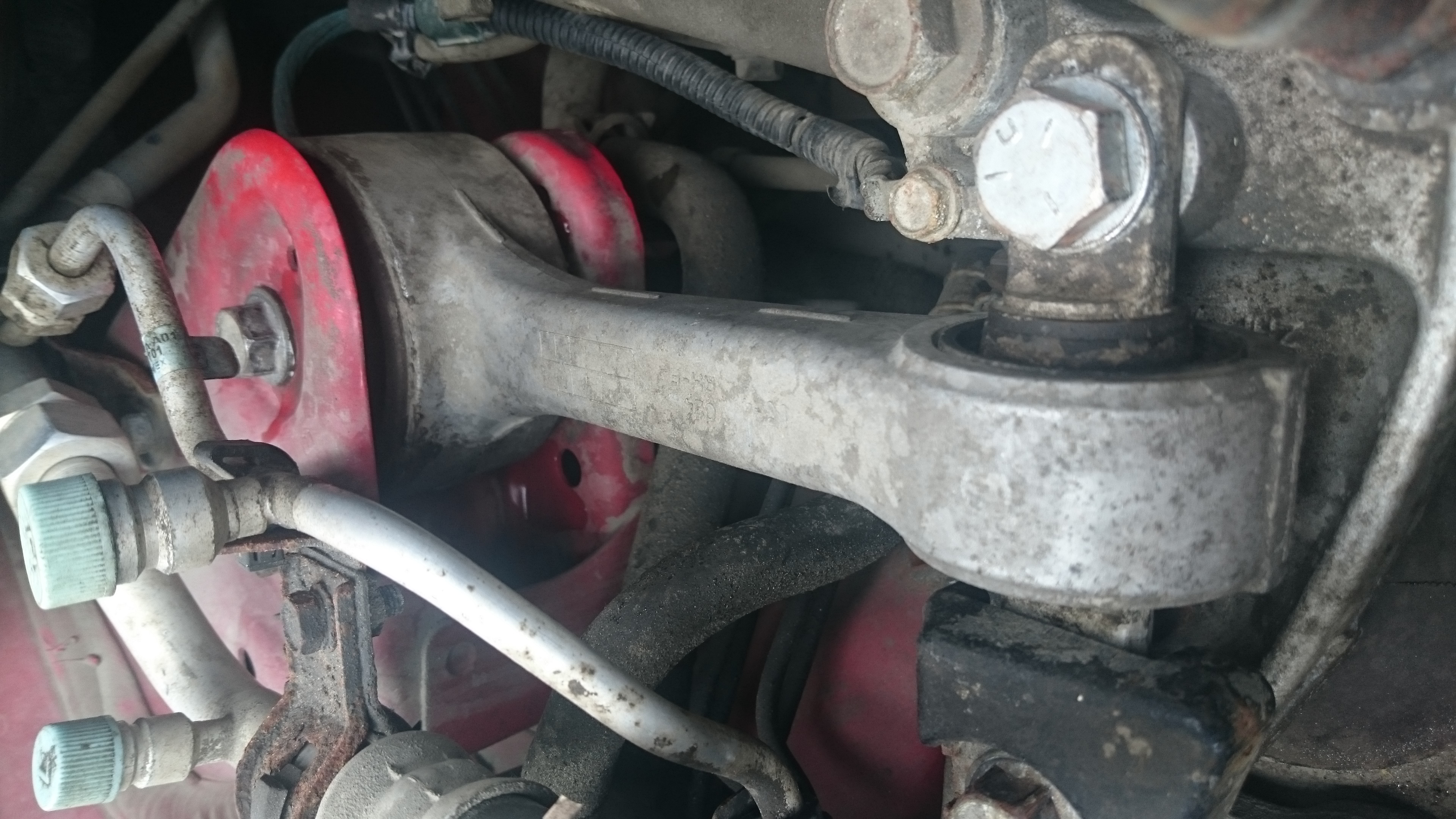

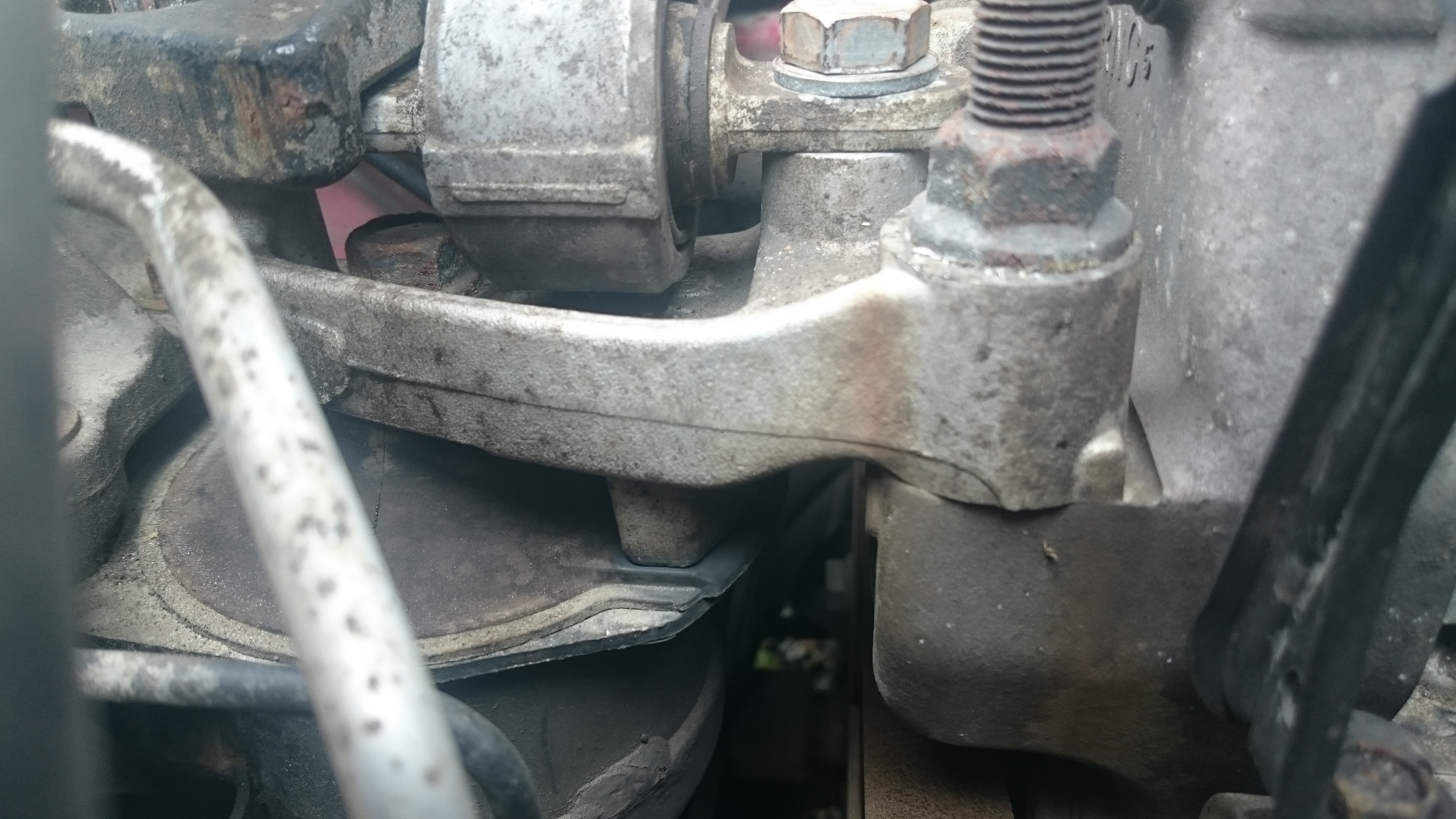

So I had the same issue...
08 civic coupe LX Manual 1.8L
The first picture is the part I checked - was told this was the motor mount. The second picture is the same I see posted in previous comments. And I DO see how that is collapsed. What exactly is that part?

BOTH parts are parts of the motor mount 'system' used in that location.
One part (upper) is used to control fore-aft movement of the engine under load-- referred to as a 'torque rod' in the parts catalog,
and the bottom piece supports the weight of the engine. THAT'S what I call the motor mount (catalog calls it 'RUBBER ASSY., ENGINE SIDE MOUNTING'), and you need to be able to pick it out in the parts catalog just to make sure you get the part you need.
Some parts department employees can only search for whatever name you call a part, and that only works once in a while.
