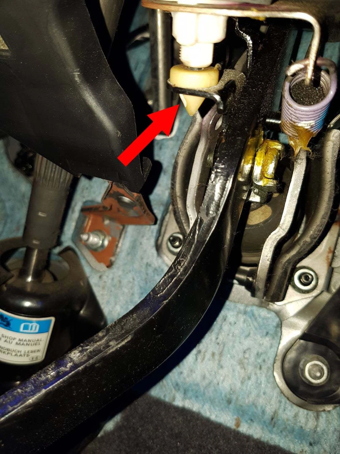

It's usually just a big ol momentary switch near the pivot of the brake pedal. Had to swap one in my friend's '08 civic. They're not necessarily hard to replace, just a bit of a pain because it's a bit of a tight-ish area.
Only thing mounting the switch is the threaded collar and the electrical plug on the back end. Unthread the collar, remove electrical plug, remove switch. Drop new switch in, thread the collar back on, adjust the position of the brake switch as necessary by the threads. The switch is normally closed, so you'll want to make sure that the switch is being fully depressed when the brake pedal is up. You'll also want to make sure that the switch is not depressed (e.g. switch shut) when you depress the brake.
Before you go and replace it, I'd honestly check if the brake switch needs to be adjusted. There's also a chance that the switch stopper broke and it's not depressing the switch (i.e. not opening that circuit, leaving the brake lights on). If you've noticed any mystery broken white plastic pieces, that's probably it. If you have a multimeter, you can also pull the switch and test it to see if that's actually the culprit. Should show continuity if the button isn't depressed, and an open circuit if the button is depressed. If the stopper is in tact, switch works fine, and it's adjusted properly, you'll probably have to do some exploring to find the root cause of your issue.
Nabbed this pic from an ebay listing. Arrow points at the stopper, and you can see it interacting with the switch

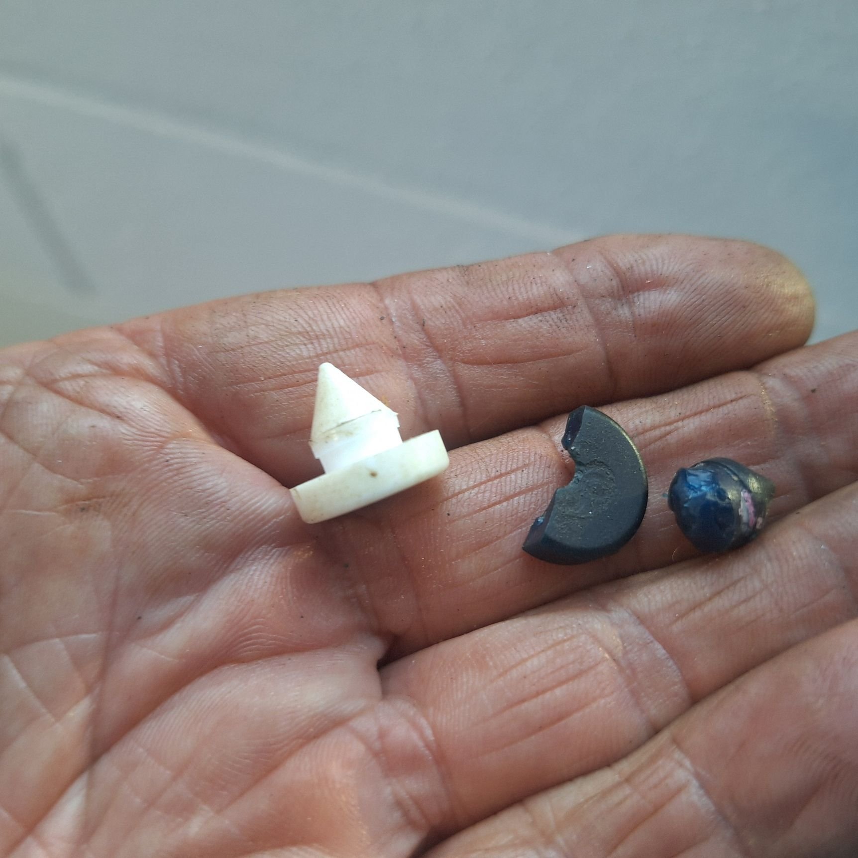

yessir . Thank you The plastic stopper was the problem. I found it crumbled on the floor. I bought a package of 2 from Advanced Autoparts for about $10.00
