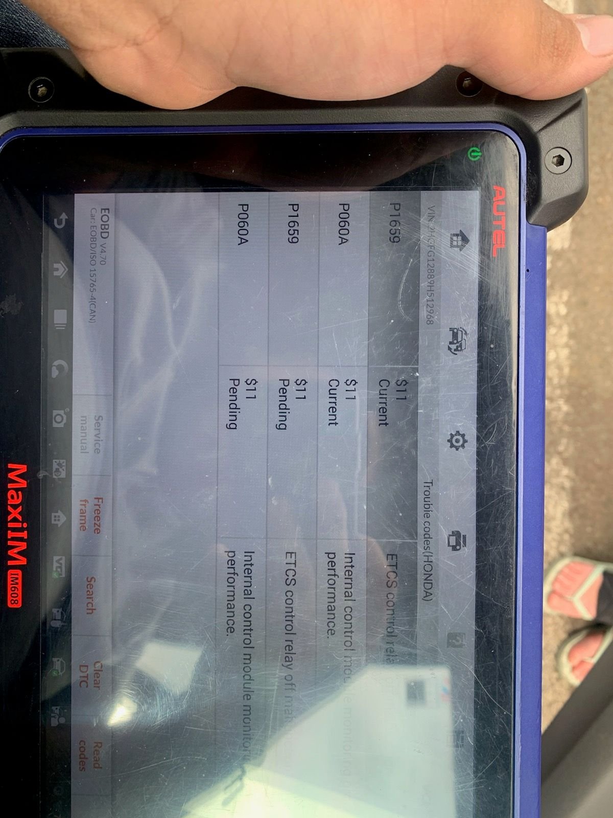

Tried starting it, it cranked at III but does not roll over to actually start. Had a guy come out and charge me $126 to tell me the immobilizor was fine and the key was fine but 2 codes: P060A and P1659 kept coming on. He called his buddy, he says it's a possible corrosion on an ecu plug and that there isn't communication between the coilpack and throttle sensors...

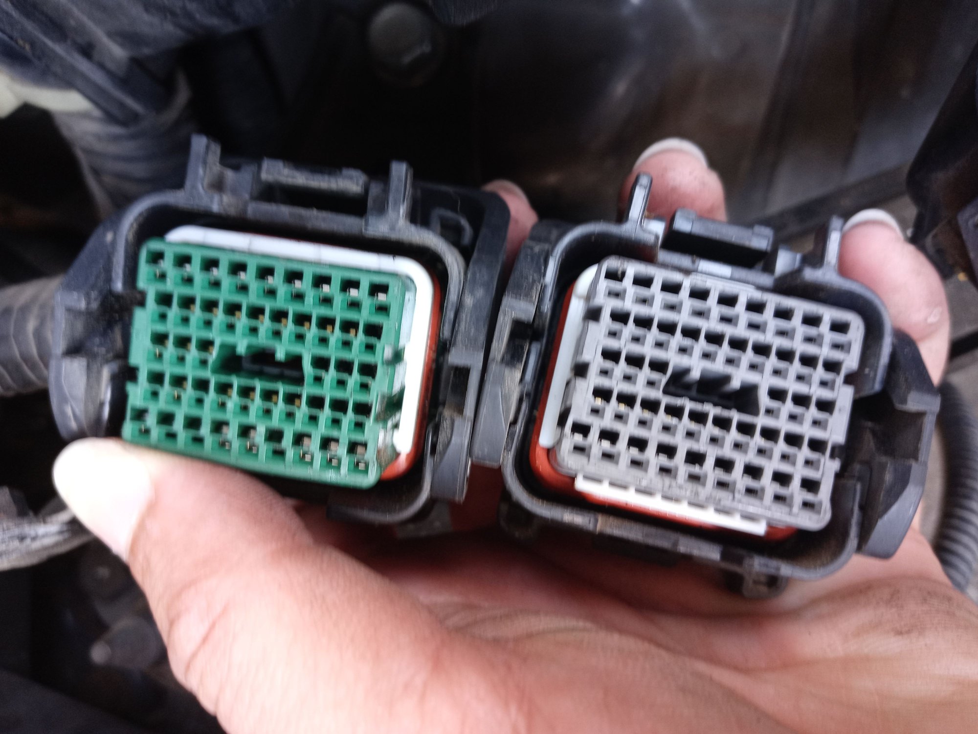

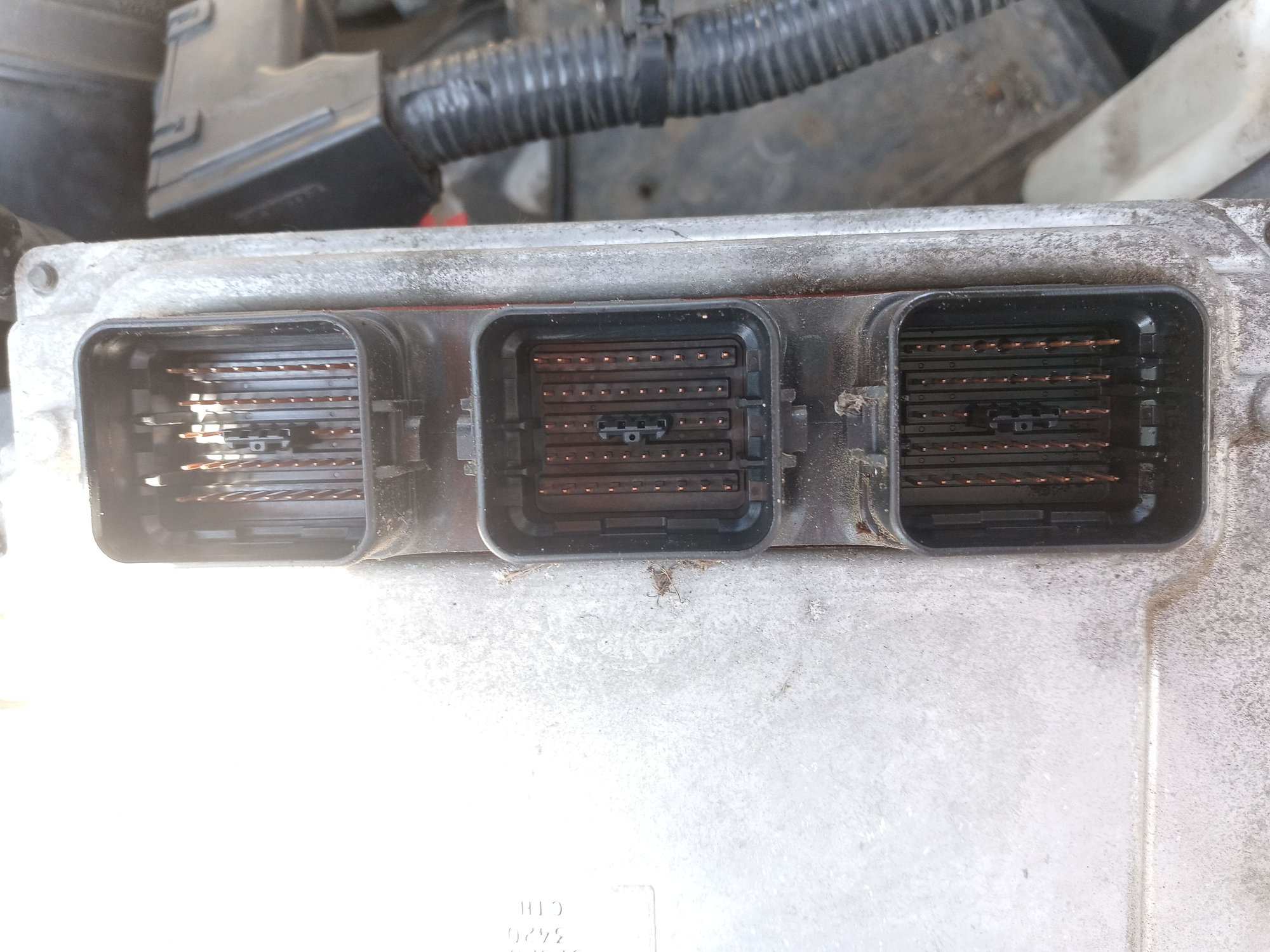

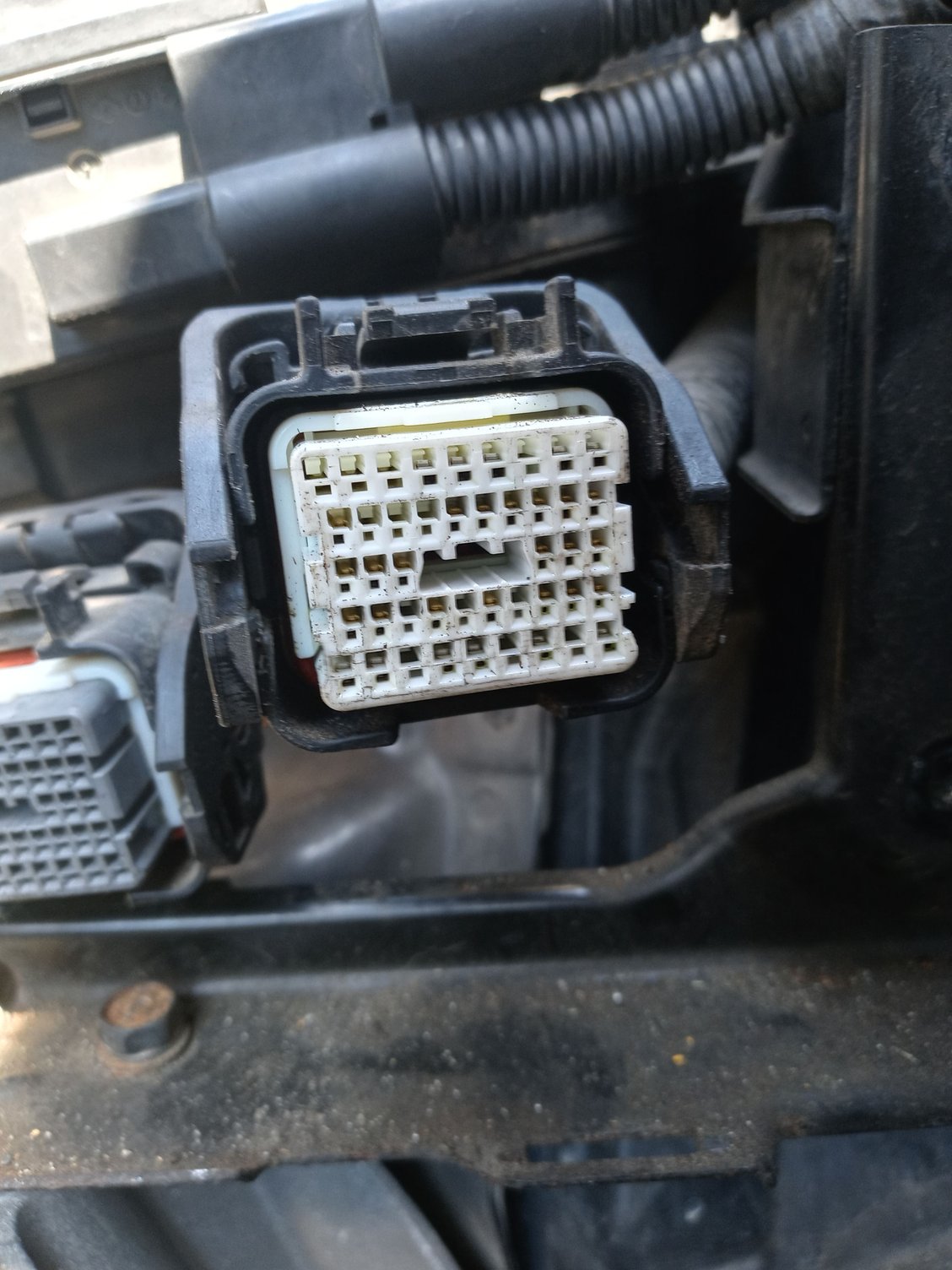

Okay so mini update. I checked all the fuses and relays with the multimeter. There were all fine so I didnt short anything. The base (not sure what its called) where the fuses and relays plug into are also all fine except one. I checked it with that lightbulb thingy. I think it might be my ac condensor cause one of the positive sides doesn't light up, indicating it's bad. Not quite sure how I would go about replacing that quite yet. Cause theres still the issue of the green key light. Someone said to check the computer for corrosion, but I don't see any from the pictues I have attached below. Not quite sure what to do next. Thoughts?
Old Aug 30, 2022
Posts: 15,190
Likes: 1,609
Re: 2009 Honda Civic AC Problems to Green Key Light Problem
use a multimeter and check for continuity on that AC? Sometimes it's the wire itself that fried or shorted
