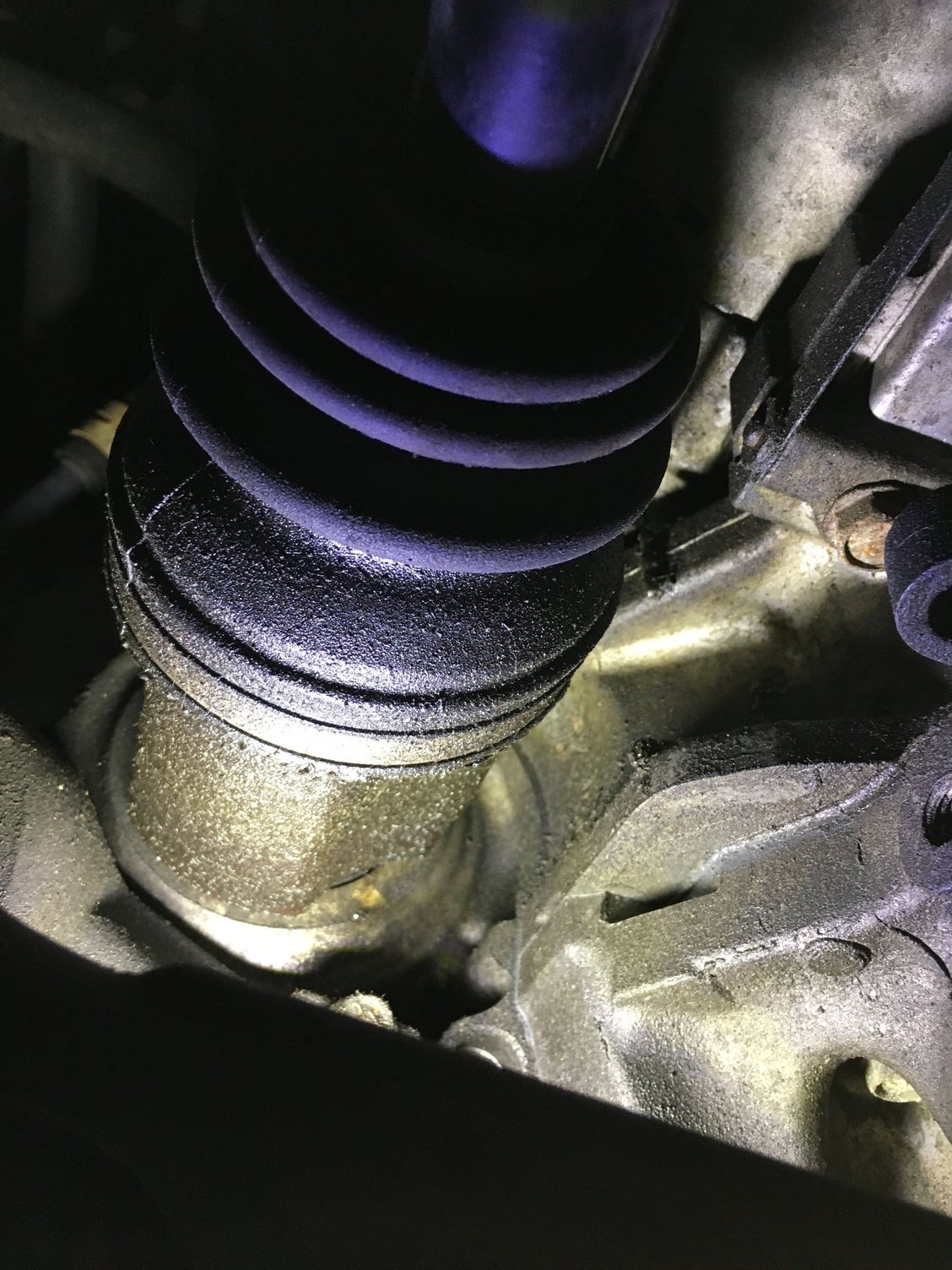

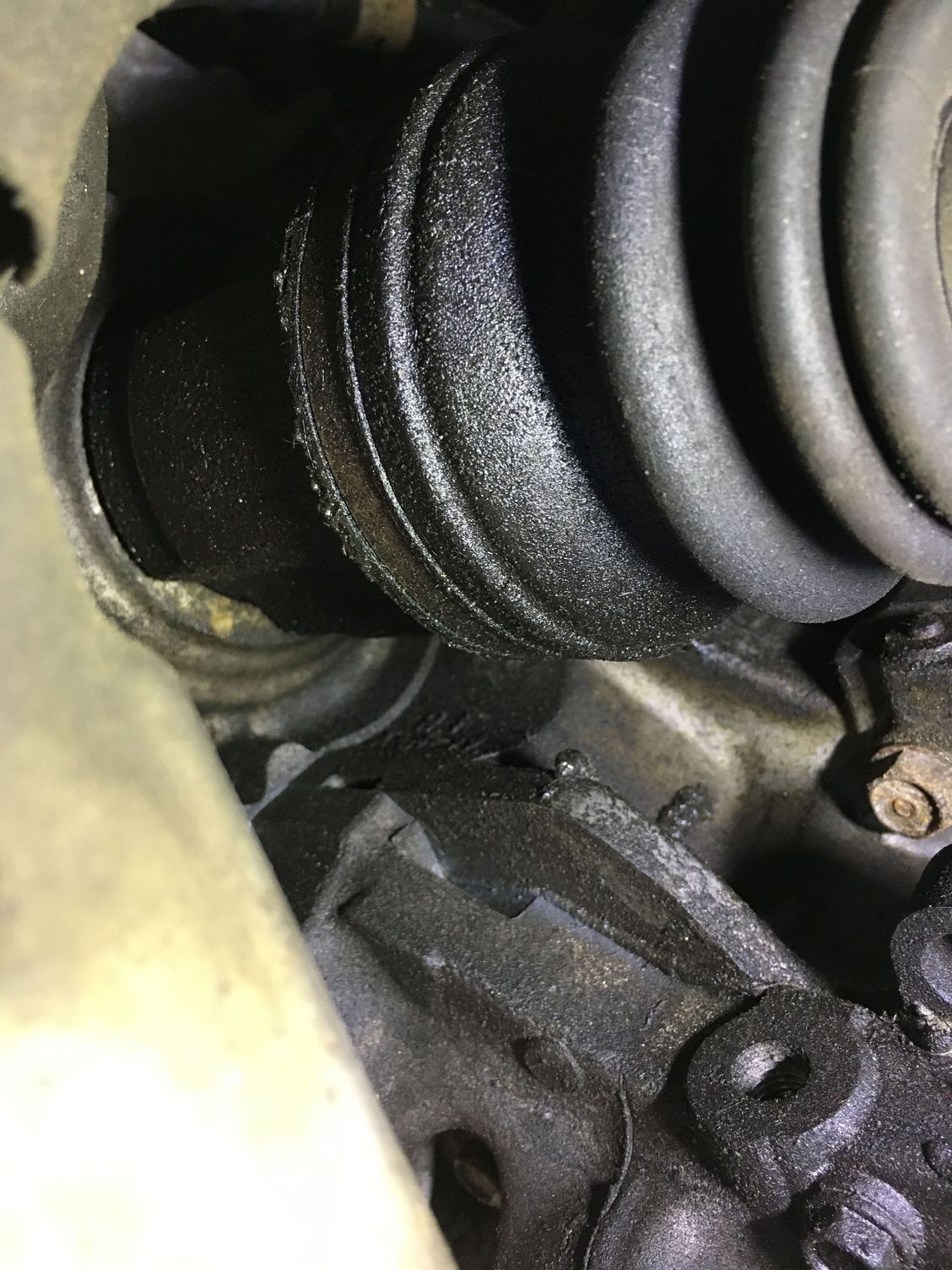

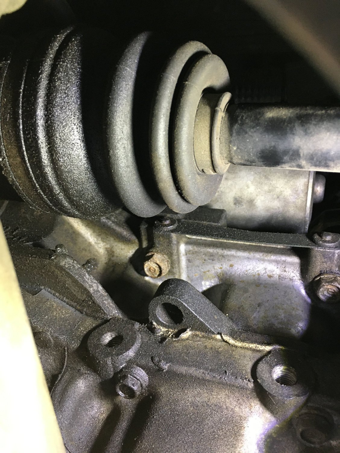

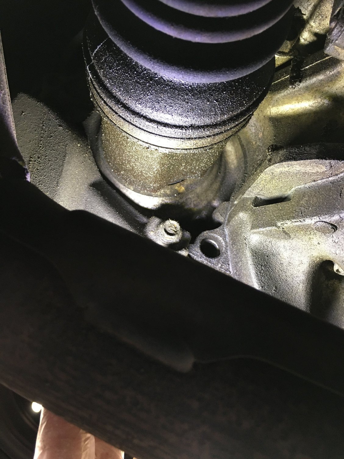

Thanks guys! Is there a seal at the backside of the wheel bearing AND where the axle meets the transmission? Also, right now there is moisture where the passenger side cv axle meets the transmission. Is that probably due to a bad seal? Is that most likely transmission fluid? I'll include photos...
Passenger side cv axle into transmission

YES, there are seals where the axles meet the trans.
NO, there are no seals behind the wheel bearings where the axles fit into the hubs. There are flanges/lips at the ends of the axles before the splines that fit into the hubs.
So YES, you may very well have leaking seals at the trans where the axle goes into. When I did my axles I did not have any fluid leakage and the seals were fine. But perhaps I just got lucky. Replace your seals.
However, the moisture in your pictures may also be another leak. I doubt it based on the area of the moisture and that there's no "pooling" of oil anywhere. But if you want to be sure, get a car wash with underbody flush, get underneath the car and wipe everything as clean and dry as possible, and then drive it around for a day or two. Look underneath again afterwards and try to pinpoint the leakage.
