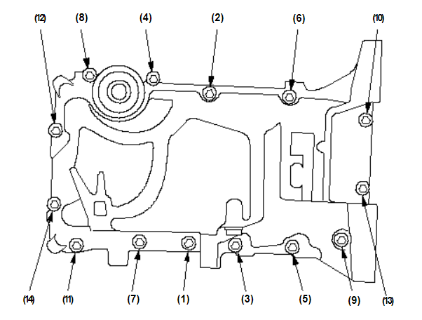

Snug, they're little tiny bolts, use a 1/4" drive ratchet. Hopefully you didn't get any major damage, not sure if the engine will shut off automatically.

I have never torqued oil pan bolts. As mentioned, just make them snug. If you really want to torque them to spec, this is from the service manual:
  • Tighten the bolts in two or three steps. In the final step, tighten all bolts, in sequence, to 18 N·m (1.8 kgf·m, 13 lbf·ft).

Thanks for that diagram. I got it back together tonight. 3 1/2 hours. 45 minutes was the serpentine belt. Gonna give the Honda Bond 24 hours to set. Flush and refill tomorrow followed by some crossed fingers that no damage was done .
