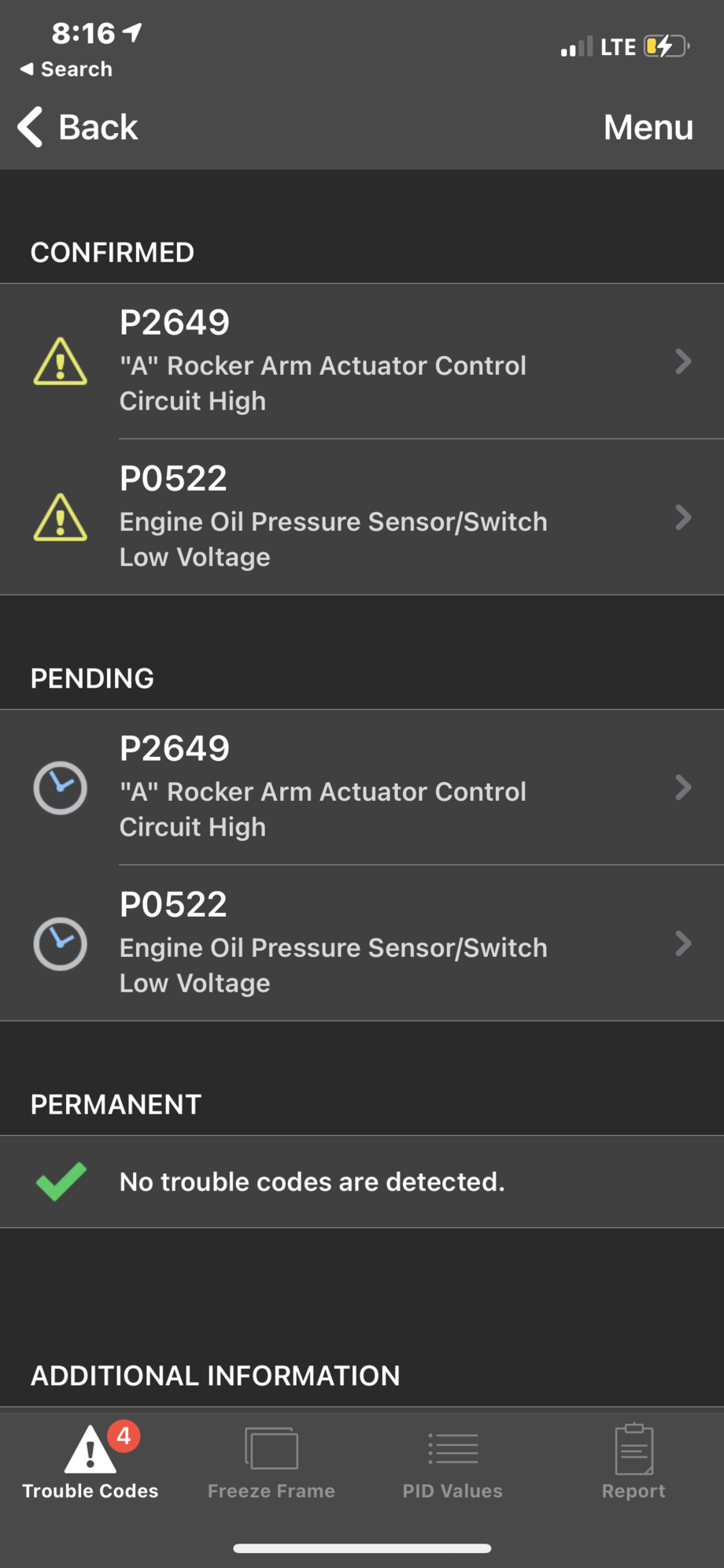

I just recently replaced my VTEC solenoid gasket because it was leaking everything went well I thought and there is no more leak however I have this issue now as well as these error codes I tried replacing excuse me reseating
the VTEC solenoid gasket today to no avail the issue still occurs. I am losing power after 3000 RPMs when accelerating, it is sort of like a jumping feeling. I posted a video make sure your volume is only you can hear it as soon as I go past the 3000 RPM mark.

retrace what you did.
I would simply disassemble/assemble it again. electrical connectors as well. check if wires insulation brittle
reset codes
see if anything was out of normal
