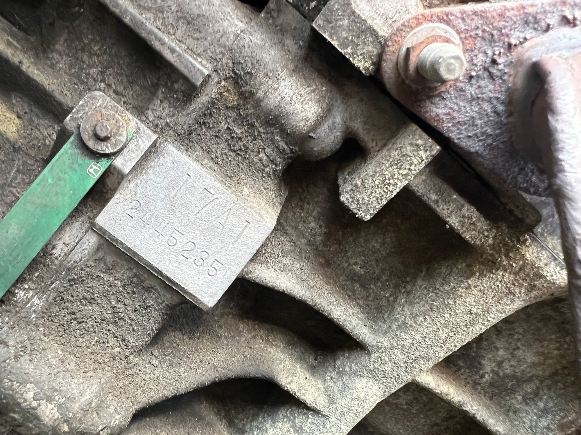

2002 Honda civic ex sedan
throwing codes p1259 and p1491
engine is stamped d17a1(non vtec after research)

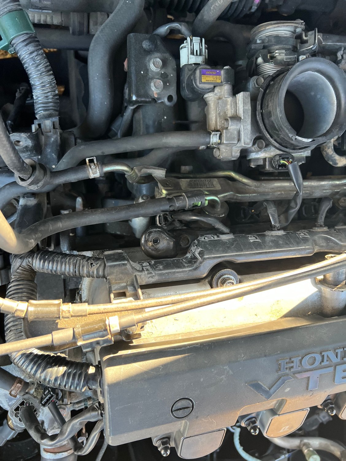

bought car used, don’t see a solenoid or anywhere I could put one also there isn’t an egr valve(delete?)
is this not the original engine?

It's throwing a vtec code because it's looking for vtec that isnt there. Someone put the wrong engine in. Ex is supposed to have a d17a2. You would need to put an a2 head on at the minimum.

or put a non-EX/Si ECU in it

Someone half-assed an engine replacement.
