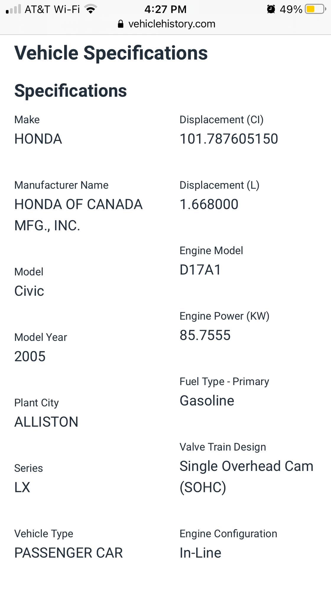

I have removed everything but the solenoid and I have done a VIN check so that is how I believe it is still an LX. I have also run a diagnostics test but maybe that was false because it wasn’t connected but it did come up with an error code. I guess why would there be a solenoid on the engine without any connections? Would love to get to the bottom of this. Thanks for the reply.

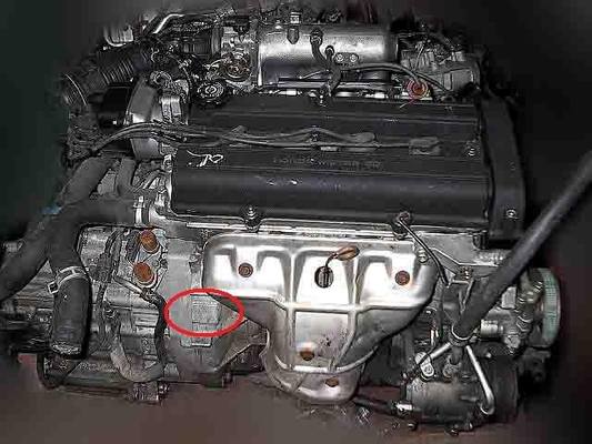

Check the actual engine stamp to see what engine you have. If the engine you have has a VTEC solenoid, someone did a swap.
This pic is from a B series, but the D17 has the engine stamp in the same spot
if it says D17A or D17A2, it's a 1.7L VTEC engine. If it says D17A1, it's a standard dx/lx non-vtec engine

Yep you are correct it is a D17A2 engine. So that makes sense when I did the diagnostics it showed as a 2004 Honda Civic EX. So it looks like the Vtec Solenoid was disabled or never enabled because there are no adapters or holes coming out of the engine wiring harness. My next question is can I enable the solenoid so it works and does not continue to cause the engine to buckle at around 2700 rpms? If so, I don’t know where to find the wire adapters without purchasing the whole engine wiring harness. Where do the adapters (wires) end up?
