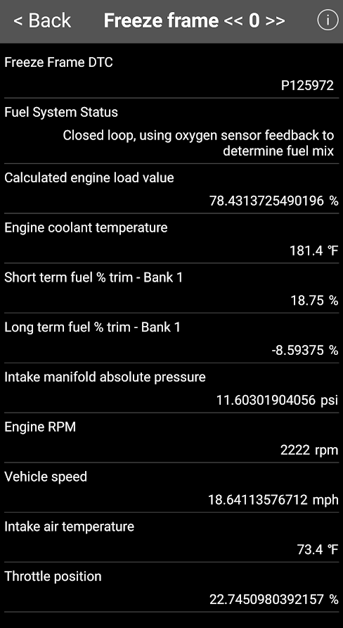

p1259 Freeze Frame Data
I'm not really sure what I'm supposed to be looking for to fix my issue. It comes and goes often for the last few years. It also throws p0112 that goes away too after a couple of drives. I'm not using my car much recently, maybe once or twice every two weeks. Could that be the cause?

Re: p1259 Freeze Frame Data
VTEC malfunction, check oil levels
Also oil condition. Would also be a good idea to remove the VTEC solenoid and clean the little filter.
