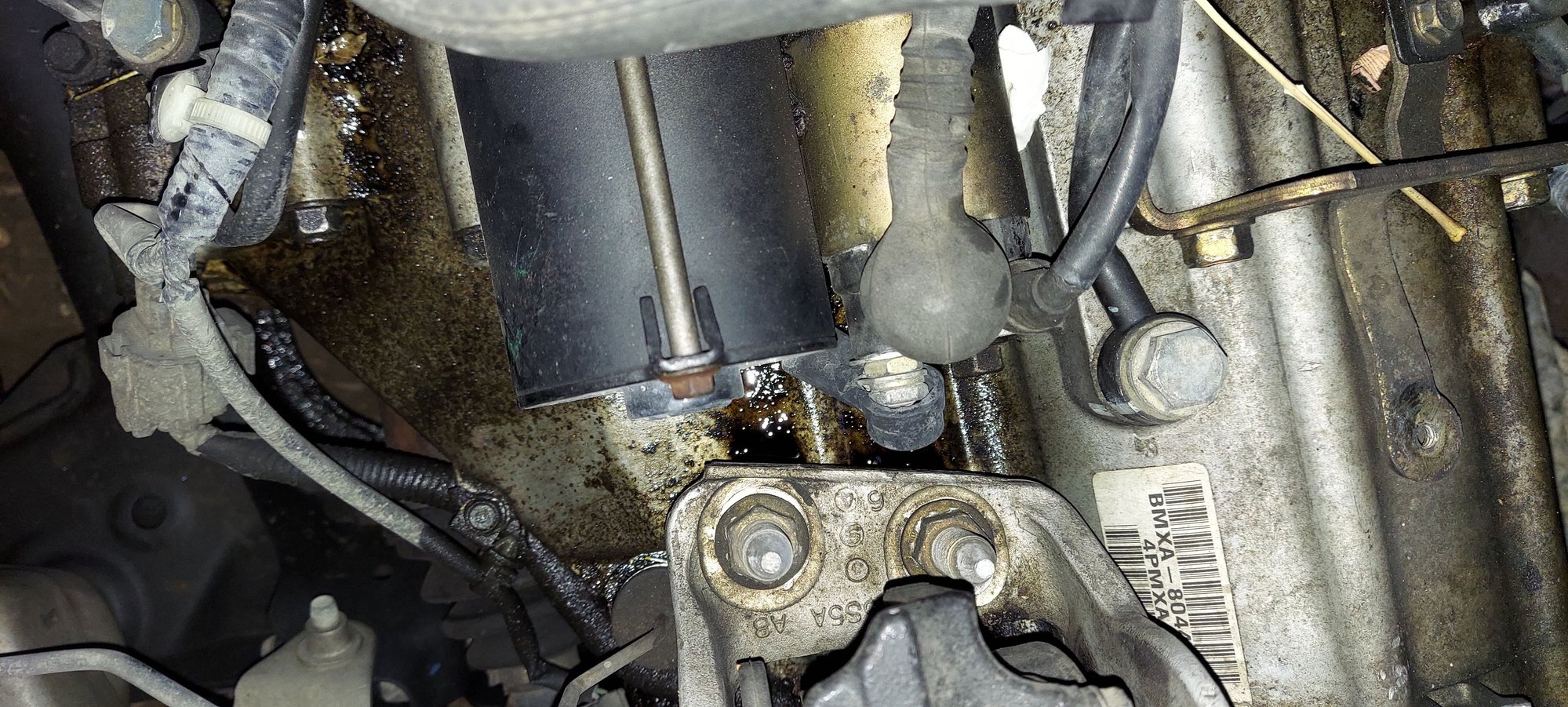

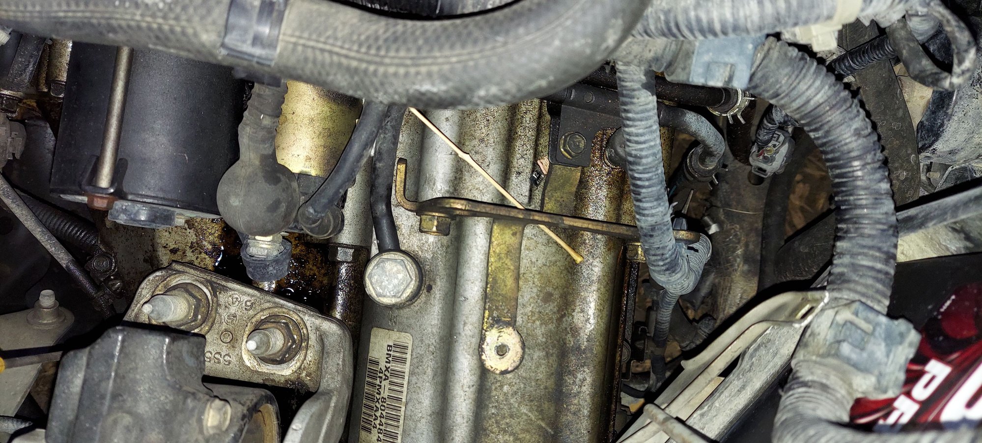

Hey guys I have a 04 honda civic, that just had the crank shaft seal replace because it was leaking. Well now there is another place that's seems to be leaking. Does anyone know what it could be

the highest point with oil is the culprit.
See other side of the engine and the side of the head.
typical ones are:
- VTEC solenoid (If you have)
- Camshaft end plug
- Valve cover (yours maybe good?)

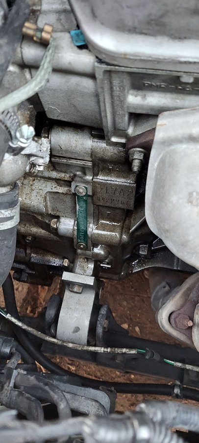

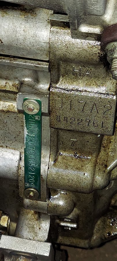

you should have - I see in your pictures your block is D17A2. Unless someone swapped a non-VTEC head, that is

if not the usual suspects...
Crankshaft seal or trans are leaking again... need check which is losing oil

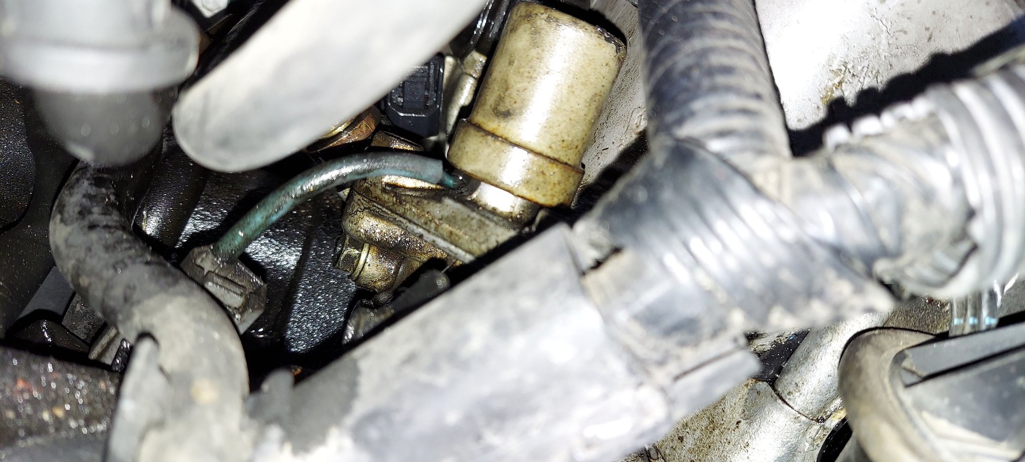

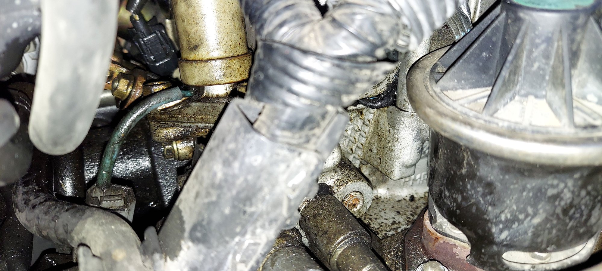

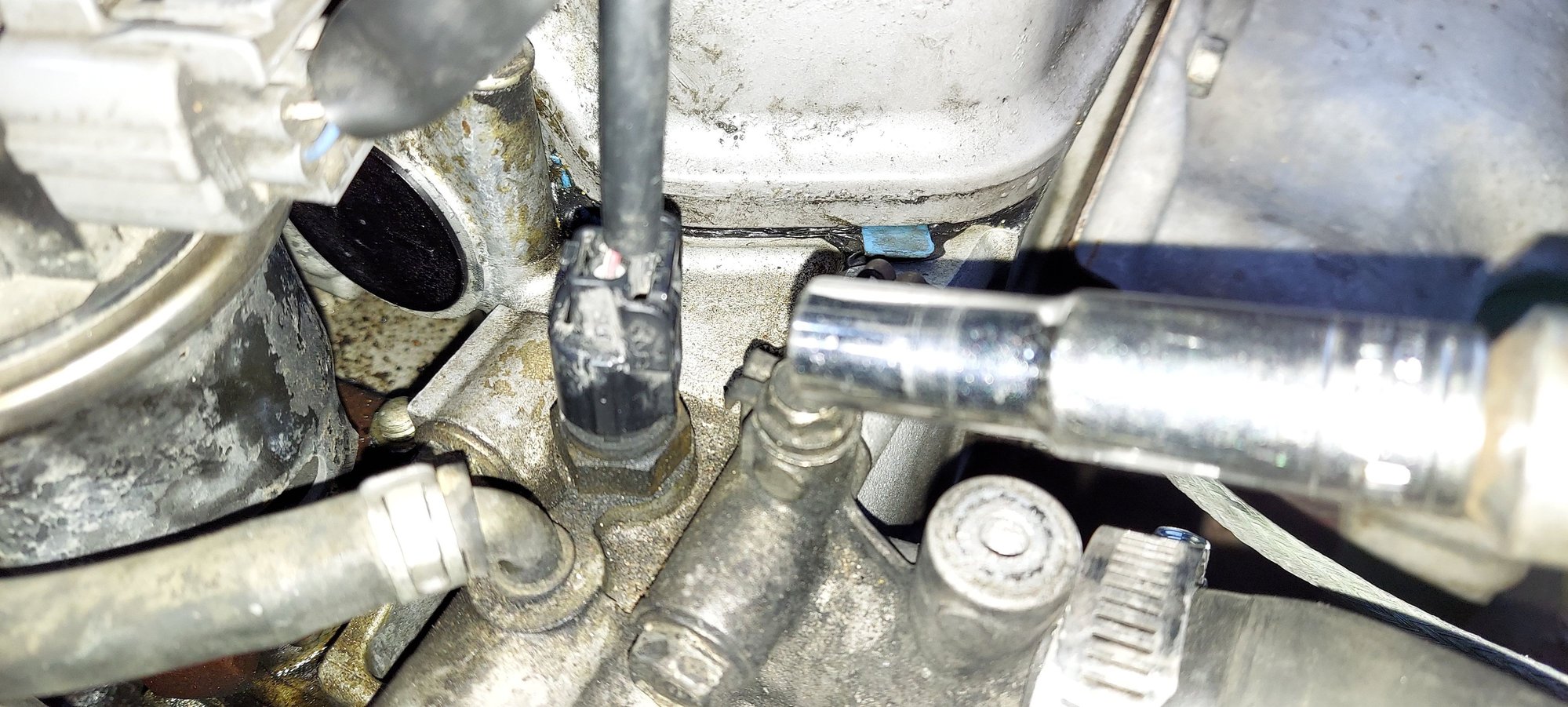

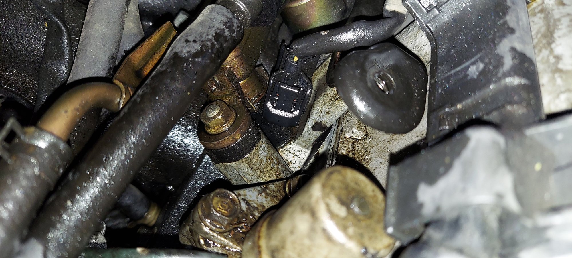

here are some pics i took off were the vtec solenoid is located.

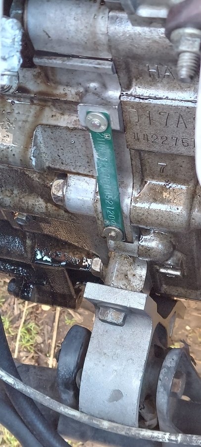

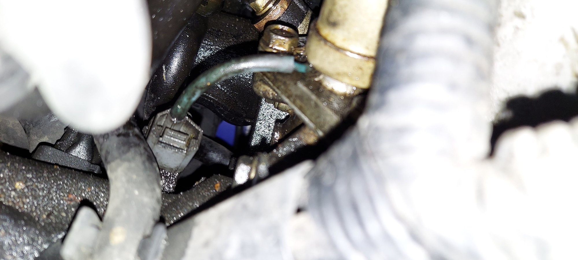

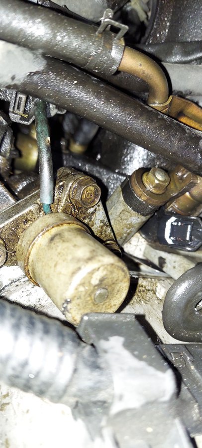

here are more pics

looks like time to remove the VTEC solenoid, gaskets and don't forget to clean the filter while at it
