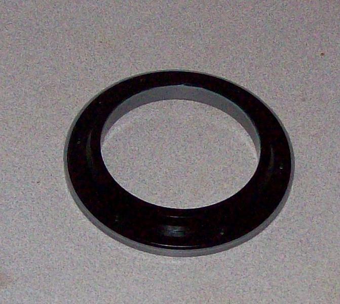

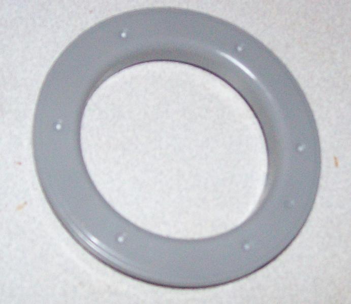

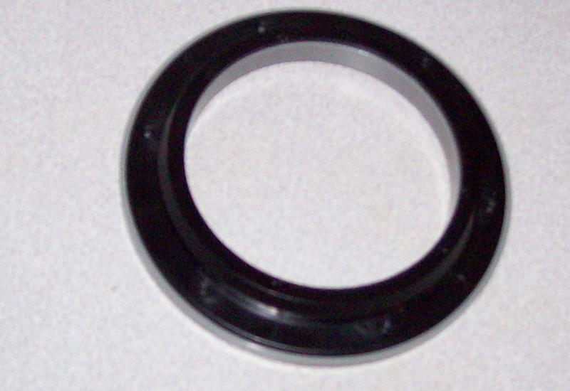

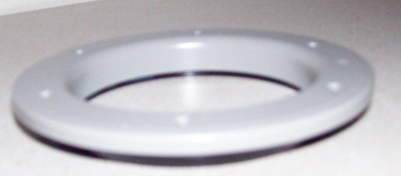

So I got the parts that I ordered last week from Majestic
You guys remember that they confirmed that the bearings will metal !
Check the pictures and see your self They are plastic
What should I do now ?
[ATTACH][ATTACH][ATTACH]Click image for larger version

Old Dec 21, 2010
  #71
Posts: 15,179
Likes: 1,606
Rep Power: 367
Re: 01 Civic front rattling...I am fed up!!!!
take it back with the email printed.
but most likely they will say the bearings are metal

The emailed me back.
We do apologize for the inconvenience. Like we said, it wasn't in stock to confirm and that we had never seen a plastic.
We'll mail a prepaid return label, and get you a full refund.
Should keep it and deal with it ? I have no other option ! I dont want to pay over 100-150 to switch to metal 02+ bearings
I mean does this plastic part last for years?

Old Dec 22, 2010
  #73
Posts: 15,179
Likes: 1,606
Rep Power: 367
your original ones lasted a while, right? should be similar.
and the tie-rods - if they sell on the dealer, they might be under some quality control - just being from china does not mean they are bad. they do have good stuff from there also, since they will just keep the bad ones for sales internally or to other shady parts.
how many clothing do you have that is not chinese?
True ! I kept them and will see how long they'll last!
The Tie Rods looks good though... China but good quality
