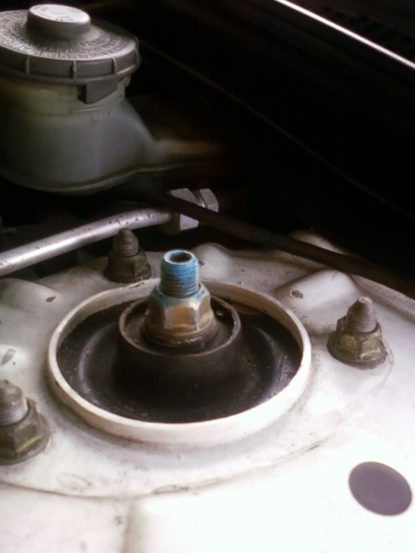

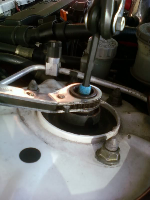

Hey check to see if the top nut on your strut is tighten down all the way. I had a knocking rattling noise for awhile before i figured out i didnt tighten enough. You have to jack up the front of the car and take the weight off the front struts, then tighten the top nut down useing an allen key and 17mm closed wrench. After i did that no more rattle/knocking. Hope this helps

Re: 01 Civic front rattling...I am fed up!!!!

You gotta make sure you take the weight before tightening the the NUT!
Try that and see if the noise goes away..If you tighten the nut with the weight on the car youll tear the rubber on you top mount.

you tighten the nut right and dont move the alan key? i tried that before but it wasnt moving at all. i guess its already tight.

ya the nut but you use the allen key to keep the strut rod from moving when you tighten the nut..
