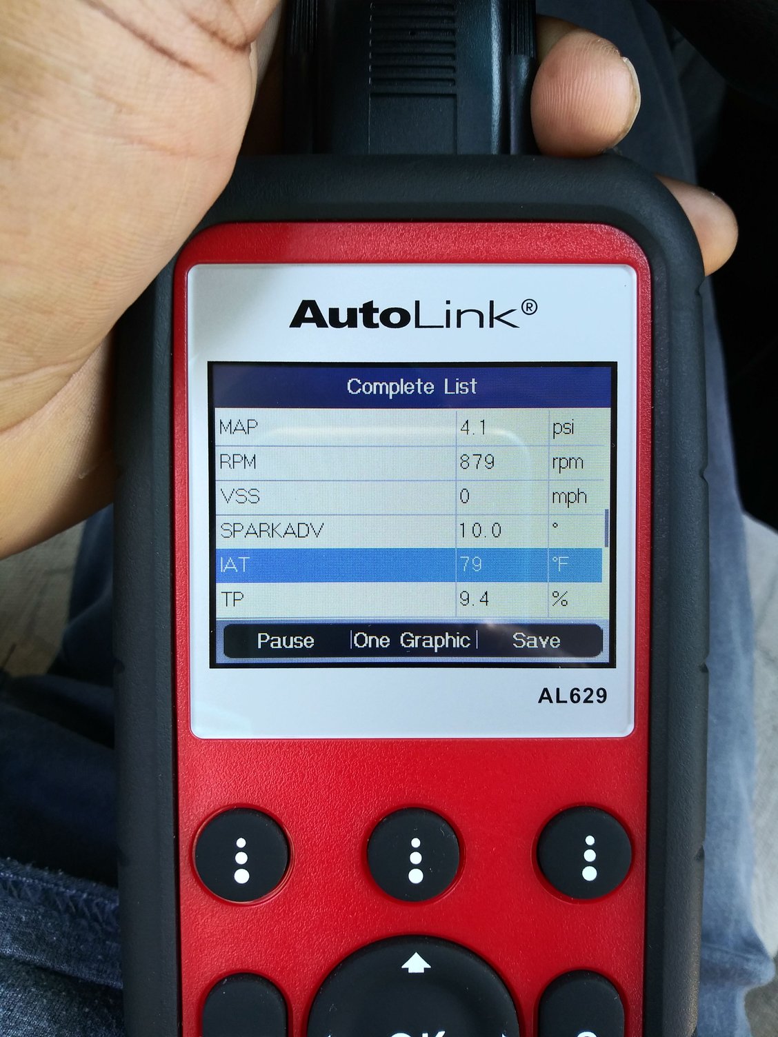

so i did what you said i should do. I connected my scanner and go to live data while the engine is running and the result for the IAT Sensor was 79 °Fat first and tgen it move to 84 °F afterwards. The sparkadv i dont know whats that for but I'm assuming its or the plugs. I was looking at motion wave form of data thats shows lines going up and down. The lines wasn't stable either. Some lower than some. I will take pics of that later after leaving work so u can see.
Why can anyone upload videos from their phones on this site? It woulb be better if i can show the vide of what the Sparkadv was showing me on the scanner.
As long as the ambient temp was also somewhere around 79 degrees when you started it that looks alright. Now wiggle the plug and the wiring for the sensor while watching the temp reading and see if you can get it to change, if you can that indicates a problem with the wiring. Also, look in the sensor's plug to make sure its in good condition with no corrosion, that could cause this issue too. Since the sensor seems to be reading correctly, my guess is that there is a wiring or connection problem that is causing the sensor to randomly lose its signal. The ECU will set a code if it loses the sensor's signal even just for a second, so a loose connection or damaged wiring could definitely cause this.
What you are seeing with the spark advance is probably normal. My spark advance moves around too, it may even read negative at idle. Basically that's a reading of how many degrees of crankshaft rotation before the piston reaches the top of the cylinder the ECU is firing the spark plugs at. The ECU is always reading sensor data and optimizing things based on temps, fuel trims, RPM, load, etc, so don't expect it to read the same at all times because its not going to.
ok. I wiggled the wire just behind the sensor while looking at the scanner but it didn't make any changes.
I might have to trace further on the wiring for any signs of damage.
Yeah it sounds like you will need to, at this point it's either the wiring or the ECU and a wiring problem is much more likely than an ECU problem. Check anywhere where the wiring harness is close to anything that could rub through it or damage it like metal brackets and such. Make sure no wiring is pinched under bolts or other components too.

if the pcv valve installed without the washer will it send off the p1505 code? I didn't know it should install with a washer because i didn't get one from the dealer when i bought it. I was watching a video and saw it installed with a washer.
I didn't even know that these cars could set that code, but the definition of that code is "Positive Crankcase Ventilation Air Leakage" so yeah I suppose not having the sealing washer could cause that if air is leaking around the valve. Just get a washer and install it, no point in looking for a problem while ignoring a problem you know exists, especially when it is so easy and cheap to fix.
Actually I suppose any vacuum leak could cause that code since the ECU would have no way of knowing if the extra air is coming from the PCV valve or anywhere else, it just knows that more air is entering the engine than what it expects. If you still have that code after installing a sealing washer check for vacuum leaks, these cars have plastic intake manifolds and mine cracked years ago, it was causing issues with the way it ran but I don't remember what codes it set, if any.
thanks for athe information. I sprayed brake cleaner around the manifold but i didn't get any different while the vehicle was idling..these civics are some pain to deal with when they start to acting up.

so i changed lower hose on the idle air control valve that goes to coolant line from the left side of the engine, it have cracks on it so i thought it would cause problems that related to my issue I'm having now and put a washer on the pcv valve but the issue still remains the same. I even sprayed soap water around the vacuum hoses but nothing.i will do a smoke test in a few days to see whats going on.
They are a pain when they have a problem, but most cars are way worse than these to fix. I used to think the same thing until I realized how many cars were waaaay worse, then I realized how simple and easy these cars really are.
